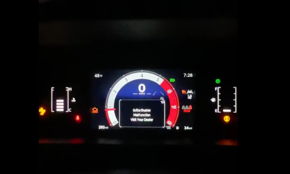

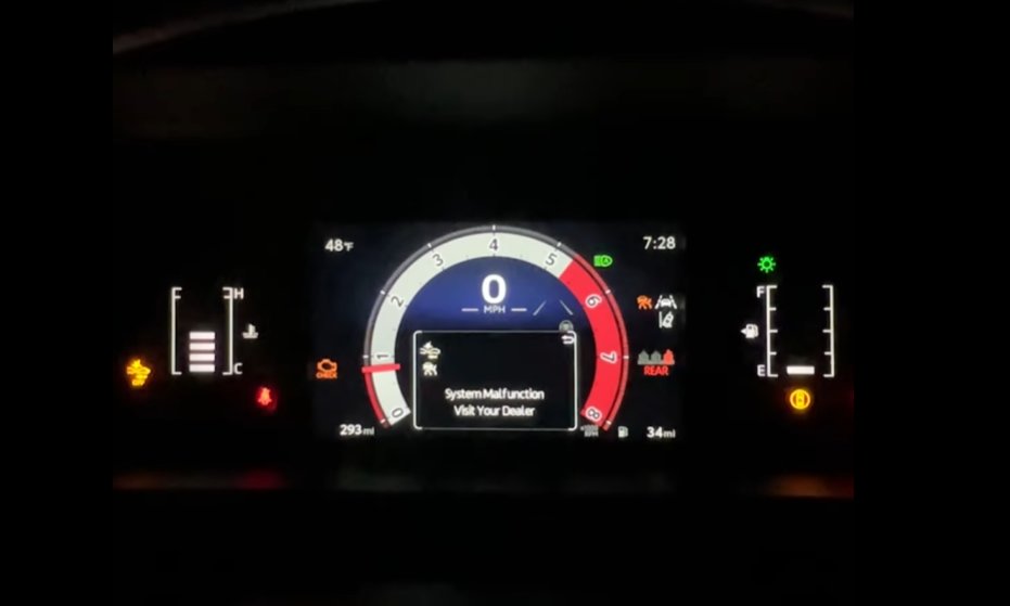

    Lets see...grill shutter malfunction, Check engine, system malfunction....Looks like 293 miles on it.
    First year vehicle problems? The last one looks like it might be an issue with TSS. Screenshot 2024-02-13 211329.png

    I thought grill shutter malfunctions only happen to hybrids.

    Welp, I just went outside and popped my hood for the first time. I does indeed have a shutter mechanism in front of the radiator. Oh joy!

    Auto shutter thing is another failure point that will fail eventually. Off roading dirt mud can get into the mechanisms, cold icey conditions as well. Its unnecessary to get .001 more mpg out of the vehicle.

    It would be nice to 'code' the active shutter thing out. Or put a resister in the plug when it fails so it does not throw a code. Its unnecessary to spend money on the active shutter when warranty ends. Disable and remove and be done with it.

    Here is how they work on the Tundra and should be the same on the 4th gen taco.
    OUTLINE
    (a) A grille shutter system is used. This system blocks the flow of air into the engine compartment from the upper radiator grille.
    (b) The grille shutter suitably controls cooling airflow for the engine by opening and closing the shutter, reducing drag.
    (c) The grille shutter system is composed of a swing grille actuator assembly, radiator shutter assembly and ECM.
    (d) The grille shutter system is controlled by the swing grille actuator assembly. The swing grille actuator assembly is integrated into the radiator shutter sub-assembly.
    MAIN FEATURES
    (a) The adoption of the grille shutter system has the following advantages.
    • Reduces the air resistance in the engine compartment when the vehicle is traveling at high speeds.
    • Facilitates warm-up of the engine by blocking the flow of cold air into the engine compartment when the engine coolant temperature is low. This supports fuel economy.
    FUNCTION OF MAIN COMPONENTS
    Swing Grille Actuator Assembly
    • Actuates the radiator shutter sub-assembly based on the signal from the air conditioning amplifier assembly and ECM.
    • Sends a diagnosis signal to the combination meter assembly when a malfunction is detected.
    Radiator Shutter Sub-assembly
    The fins of the radiator shutter sub-assembly are closed by the swing grille actuator assembly to block the airflow to the engine compartment.
    ECM
    Sends an engine coolant temperature signal to the swing grille actuator assembly via CAN communication.
    Air Conditioning Amplifier Assembly
    Sends the A/C refrigerant pressure and outside temperature to the ECM via CAN communication.
    OPERATION
    (a) The swing grille actuator assembly performs cold condition control while the engine coolant temperature is low.
    (b) The swing grille actuator assembly performs high speed traveling control.
    Cold Condition Control
    • When the ignition switch is ON at the engine coolant temperature is below 40°C (104°F), the grille shutter is closed until the engine coolant temperature reaches 75°C (167°F).
    • Using the air conditioner with low outside temperature, the grille shutter is opened when the pressure of the refrigerant becomes higher.
    High Speed Traveling Control
    • When the vehicle traveling speed is between approximately 60 to 150 km/h (37 to 93 mph), the grille shutter is closed.
    • When the vehicle is traveling and engine coolant temperature is approximately 97°C (207°F) or more, the grille shutter is opened.
    • When the vehicle is traveling and outside temperature is approximately 35°C (95°F) or more, the grille shutter is opened.
    • When the vehicle is traveling and air conditioning refrigerant pressure is high, the grille shutter opens and closes in accordance with the vehicle speed and the outside air temperature, etc.
    HINT: Sometimes, the grille shutter operates after the ignition switch turned to ON or Off. This does not indicate a malfunction.
    FUNCTION
    (a) Warning Indication
    (1) The combination meter assembly uses the multi-information display and buzzer to provide the driver with grille shutter system malfunction information.
    DIAGNOSIS
    (a) If the ECM detects a malfunction in the grille shutter system, Diagnostic Trouble Codes (DTCs) are stored in the ECM.
    (1) The DTCs can be read by connecting the Global TechStream (GTS) to the DLC3. For details, refer to the Repair Manual.
    dleithaus, Fast1 and Taco1997 like this.
