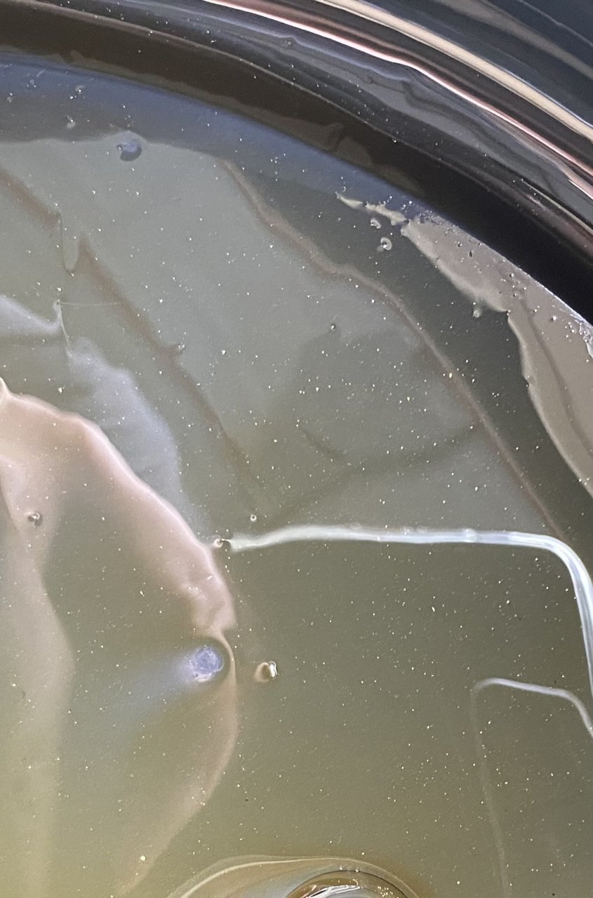

    First oil change at 1,700 miles.
    Quite a large amount of tiny metal shavings in the pan and also some captured within the filter element. Pictures are below.
    The assumption is this is normal and that such shavings are too small to cause damage.
    If you have pictures of your first oil change to compare would be awesome to share.

  2. Jul 11, 2023 at 8:47 PM
    Travlr
    Travlr Lost in the ozone again
    Jan 26, 2019
    #280725
    1,695
    Middle'a Utah
    2012 Baja Series Access Cab
    It's why they call it "break" in...

  3. Jul 11, 2023 at 8:51 PM
    Canadian Caber
    Canadian Caber R.I.P Layne Staley 67-2002
    Oct 28, 2020
    #345206
    2,568
    Les
    B.C. Canada, eh
    2020 TRD Sport DCLB 4X4 Super White
    No Pictures. I do care about maintenance on my Tacoma that I purchased brand new. I would like to get the most out of her by making sure the oil is changed regularly. I changed mine at 1,000 miles. I'm confident that there may have been some break-in material in the oil but take comfort that I regularly change the oil and don't really worry about that level of detail.
    Also, after the manufactures initial suggested break-in period I drive it without concern. Including high RPM's when needed.
    Keep your truck maintained and go out and enjoy it.

    I always do multiple break in oil and filter changes, usually find metal in the filter.
    Same with rear diff.

    We all had them. Filter does its job.

    Thanks for the corroboration. Curious why so many tiny pieces would be in the pan if the oil is being filtered ? Would these just linger at the bottom of the pan?

    Cause they are on the bottom of the pan and the strainer seat just above of the lower point?
    This may help you to understand the engine lube system

    I guess Toyota's engine manufacturing plant didn't clean that one too well before assembly. Idk, what the first 2 toyotacare oil changes were like for my truck, but the 1st one I did, the oil, and filter were spotless.
