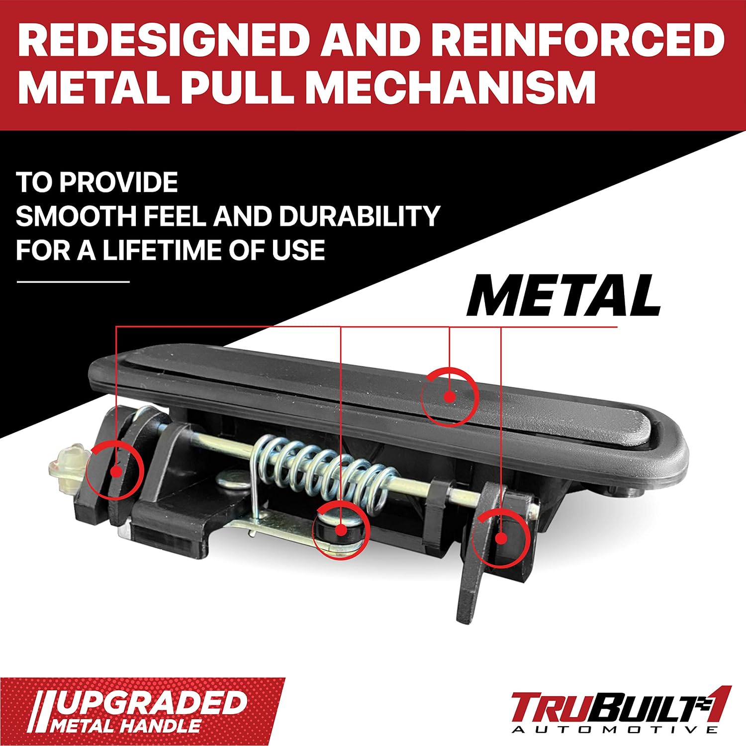

    Not sure if these would fix your problem, but I am really happy with them. My passenger side handle was cracked and tried a cheap Chinese version and it was terrible.
    These I am sure are made in china, but the company is here in the USA. They sell them individually or in sets.
    https://www.amazon.com/T1A-Passenge...b612e5f423f&pd_rd_wg=NUn5V&pd_rd_i=B07YQBPHS9

    I bought installed these this last week, they do seem to be higher quality. I replaced one dorman handle which is an aftermarket brand and one OEM handle (this was the original but recently cracked)
