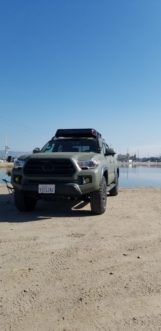

    just bought some 5100s with ome 887s and a deaver single aal. My 17 TRD OR stock suspension has 40k miles on it now, and is always loaded with 200 lbs in the bed or hitch. The ride has soften up too much for my liking so im excited to try a firmer set up on it.
    what kind of ride feel do you guys prefer?

    It would probably get firmer if you lighten up the load. Or is it still soft when empty? That’s crazy if it is
    5100’s and an AAL on stock leaves don’t exactly sound like a soft ride to me hahaha
    Good lookin truck tho

    thats the point though, I dont want a soft ride
