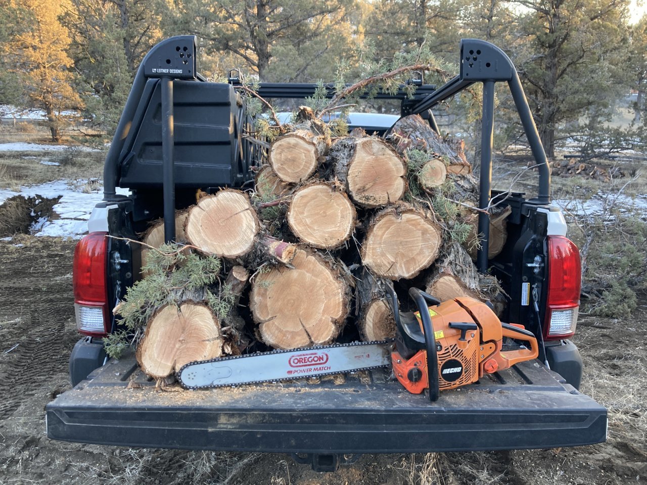

    Anyone have a firewood trailer they like that works well with the Tacoma’s payload, tongue weight, and tow ratings factored in? How much wood are you able to take in a single trip?
    My door jamb says only 900-something payload lol, I think TW is 680, and tow is 6,800.
    Building my house that’ll be heated by wood and legal cutting areas are 30miles each way on the hwy, so I’d like to maximize each trip. It’d be ponderosa.
    Been borrowing my old man’s beater 2500 with an 8ft bed but won’t always have access to that.
    I’ll likely need to buy a used 3/4 ton but hoping for some success stories with tacos + trailers to hold me over.
    A2BB79B6-A1ED-4D28-B43F-53F7CE1839BC.jpg 6184A6EA-50A8-4F3E-87E1-9D892BF08287.jpg
