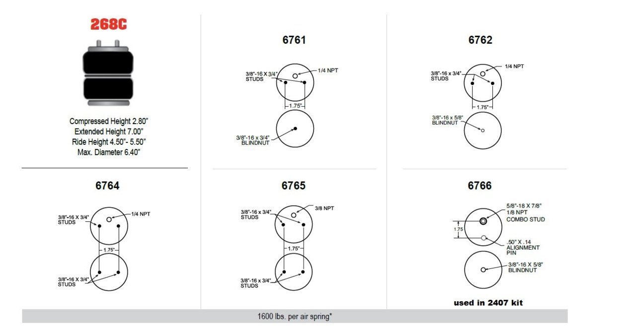

    The Firestone literature says they DO NOT have an integral bump stop. What they do have is a ''zero pressure'' stack height when fully compressed. If this height is enough to fill the sag space - you could have a problem. The Daystar seat is about 3/4 inch thick and would be an addition to the stack.

    Firestone stack height info - looks like they come "solid" at 2.8 inches.
    iliketoskipowder[OP] likes this.

    It's probably better that they allow slightly less travel than allow too much and over compress the shocks. And it's not very much less, maybe 1/2-3/4", I think the stock bump stops are ~2".
