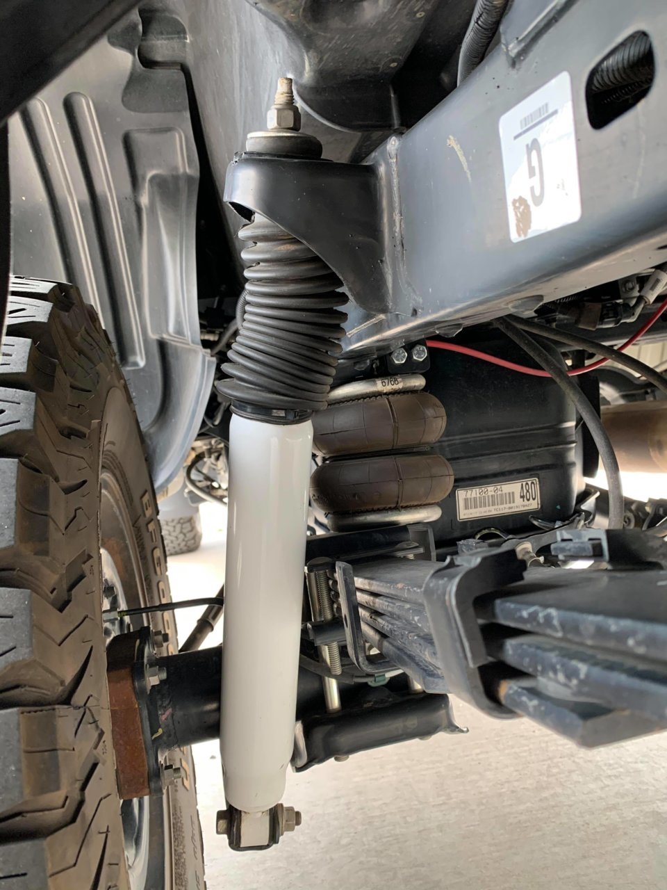

    Already logged 31,648 miles on the Firestone ride-rite air suspension. I'm using Tuff Country 3 inch lift rear shocks with stock leaf springs. Absolutely no complaints with this set up. No more sag!

    I have had the bags for about 5k miles or so (not my daily ride). My suspension is otherwise stock and I can confirm the ride is pretty bouncy. You can only let so much air out. Because the bags replace your bumpstops, you have to keep enough air in them to keep from bottoming out, and the stock springs are very, very soft. Bottoming out on the air bags feels terrible. I contacted Firestone about this and they stated the bags are designed to act as a bumpstops when the rubber compresses on itself, but it is an extremely hard bumpstop. I wound up putting a GoPro under my truck and watching the rear end going over SE PA potholes. I have to keep 15psi at a minimum in the bags, with no extra weight, to keep from bottoming out. This makes it ride like an empty F350, but with less rebound control. I found the cradles to cause the rebound to be even more severe, maybe because the body of the bags was not slowing the axle on the rebound stroke. Everyone with aftermarket leaf springs+air bags swears by them. The stock leaves seem to be the problem.

    The OEM shocks are too short. The OEM shocks are at full extended travel when i air up the air bags to make it sit level to the front.
    I'm only using the parts in the kit that Firestone provided to mount the airbags.

    I went three inches higher to level the truck so i felt the oem shocks were not made to operate smoothly at the new ride height. The trucks' rear end would jounce too much with the stock shocks, I replaced them with aftermarket "3 inch raise" rear shocks.

    Question. I’m adding the Firestone air bags to my 2016 Tacoma. Opened the box and my lower brackets are different than those in the pict. Mine are flat and bolt on to leaf. Yours appear to be bent down to contact the axle for more support. Did etrailer send me the wrong ones kit? See pict.
