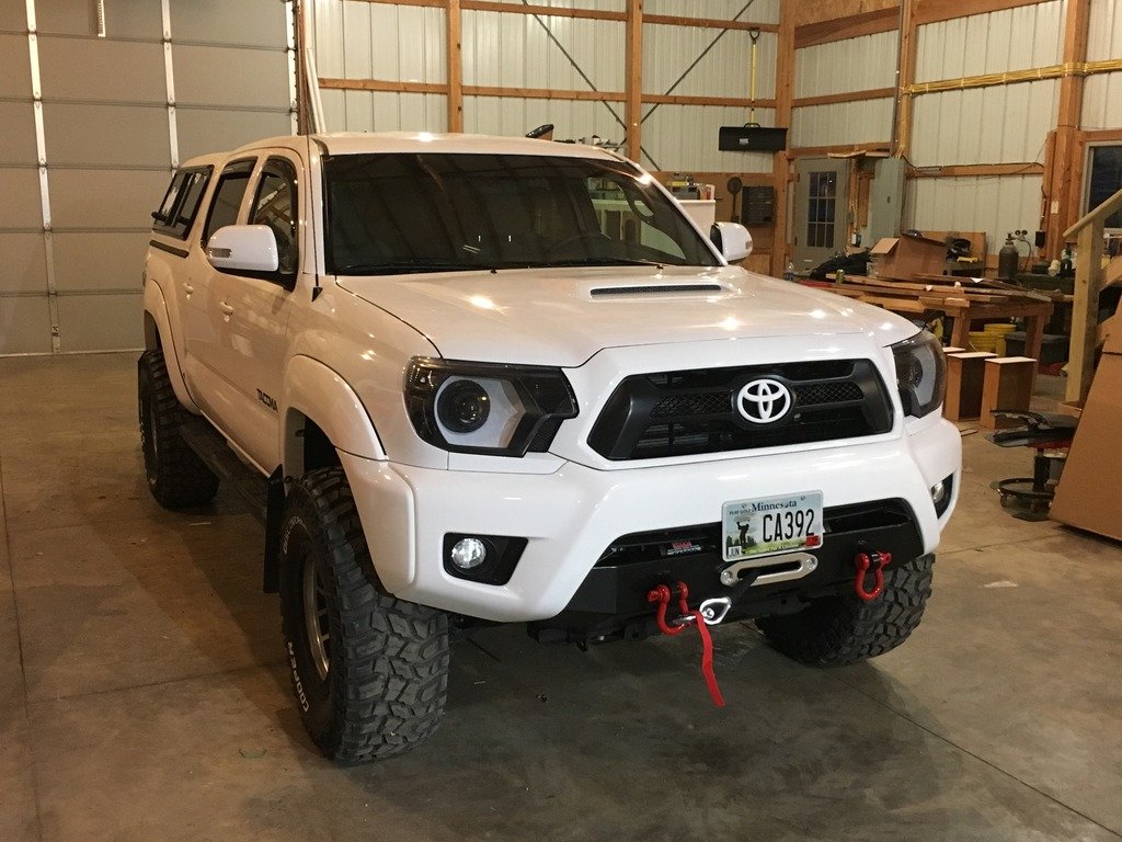

    Hey all,
    I recently lifted my truck and installed new tires and wheels but I drive gravel everyday and am looking for fender flares or ideas that provide extra coverage. Iv tried searching and no luck. I am interested to see if anyone has any homemade solutions or knows of any companies that make larger flares that I missed. Any help is much appreciated.
    Tires stick out a bit

    Iv been searching more and still no answers, and no replies here so I may be sol. If anyone has and used stock flares I would be interested in purchasing them to make mold with, but in the meantime this is what I'm thinking.
    I'm planning on taking some flat steel and cutting it to resemble the cardboard(probably wont need to stick out that much) and use the flare mounting holes with spacers to mount them and line the underside of the flare with 3m double sided stick tape to help it hold and protect the flare. I'm planning on welding small tubing on the underside edge to strengthen it and hopefully make it look better.
    If anyone has any better ideas or reasons this is a bad idea please chime in. I took it to work today, and only option is gravel travel so I have to do something looking at the size of rocks these things chuck.

    There is a lot of fiberglass companies that can make you a set of fiberglass fenders but they are expensive. You're looking at over $1000 for a set of four fenders with paint. Another option is Rokblokz or Rally Armor mudflaps. I have Rokblokz oversized mudflaps and they do a good job of keeping crap off the side of my truck.

    Im not sure if it applies to our tacos, but on my last car, my tires stuck out about 1.5" like this, and I used garage door rubber seal as a "fender flare". Its a cheaper option, but not sure if it will actually do what you need it to.
    Something along the lines of this:
    Also, what size are your tires?

    Thanks for the idea I'll have to look into that, I install garage doors for a living so I should be able to find some. The tires are 305/70r16s.

    The trick there is they measure from the steel for coverage and that's both sides... So it's actually one inch coverage per side from the steel not the flare, it ends up being the same as stock flares.
    Sorry I should have put that info somewhere I guess.
    Front-Icon coil overs w/sway bar relocate
    Rear-wheelers 3 leaf aal and icon resiviour shocks
    Tires-305/70r16 cooper stt pro
    Wheels- MB 11 16x8.5
