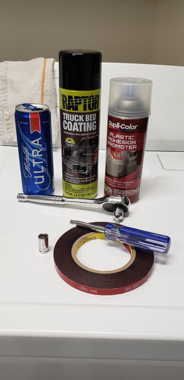

    Hi everyone!! Finally got around to doing my fender flares in Raptor Liner. Removing the fenders wasn't a huge issue. None of the bolts are hidden/hard to get to. If you have mud flaps just make sure to take those off too. The entire process took me about half a day or so. In no way shape or form do I have painting experience so Google, Youtube and TW were definitely my best friends during this entire process. I think my own inexperience caused me to spray in a way that 2 of my fender flares have some patchy spots on them but overall I am very very happy with the result!
    So I used a 10mm socket wrench, about 1.5 cans of the Raptor truck bed coating which I found on Amazon and Dupli-Color Plastic Adhesion Promotor. This is what I used because I saw a video on Youtube where this is what the person used when he sprayed Raptor Truck Bed Coating. The beer is just A MUST at this point (had it at 9am!)
    The 3M double sided strip I used is NOT like the factory foam one. I originally had the foam one from Amazon from I thought I wanted to replace my factory fender flares with aftermarket ones and when I stuck them back on I had a really hard time with it not folding on the curved parts and I ended up with more gap in between the truck body and fender flare than I wanted. The one pictured is on the thinner side but it's been a week since I've stuck them on and they seem like they are holding up just fine.
    Other items not pictured: drop sheets from Home Depot, 100 and 150 grit sandpaper and the orange and blue clips which I also found on Amazon. Thank you TW!! Luckily, I only used maybe 2 or 3 of the clips.
    Like I mentioned if you have mud flaps be sure to take these off also. They use the same 10mm bolts. Mine are factory and I have them both in the front and back.
