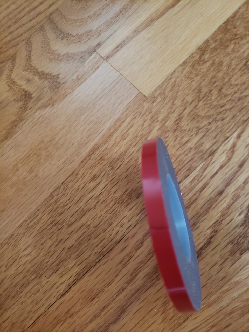

    When I repaired mine I used 1/4" m3 tape. 0.75" is way wide. You suppose to apply the tape to the edge of the flare
