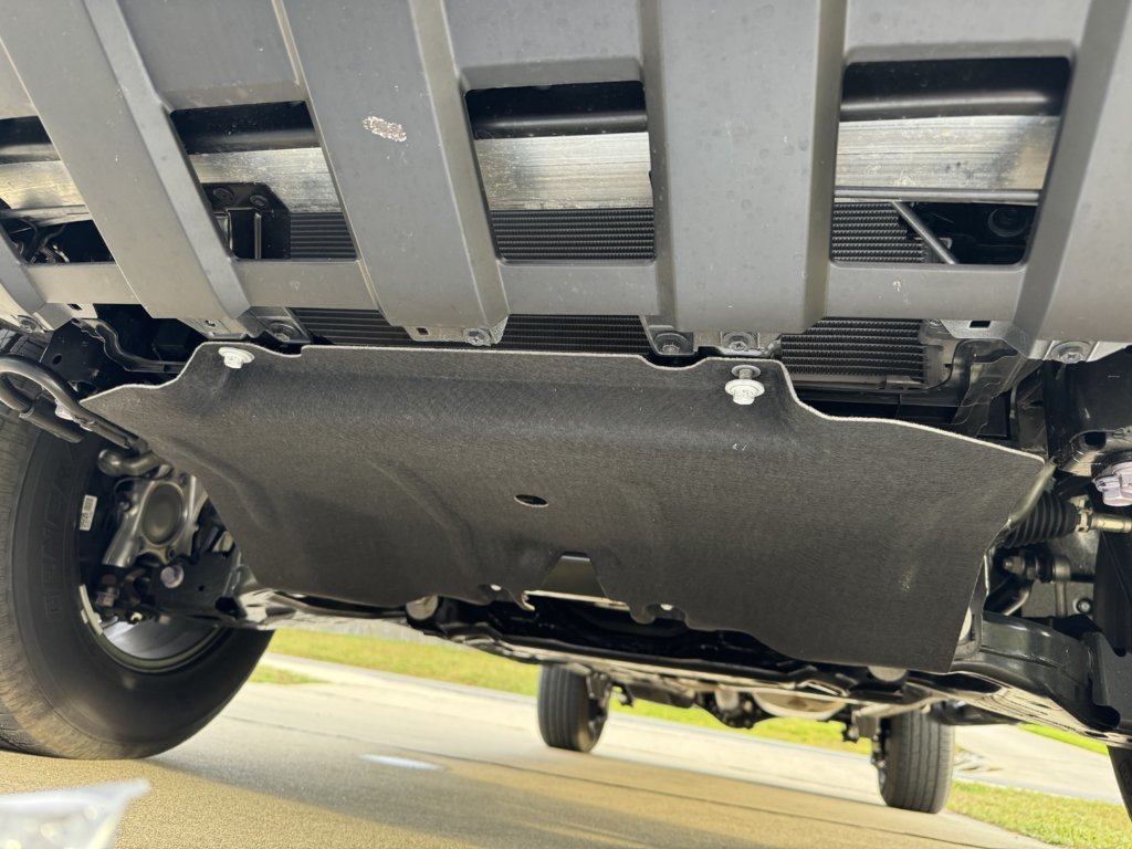

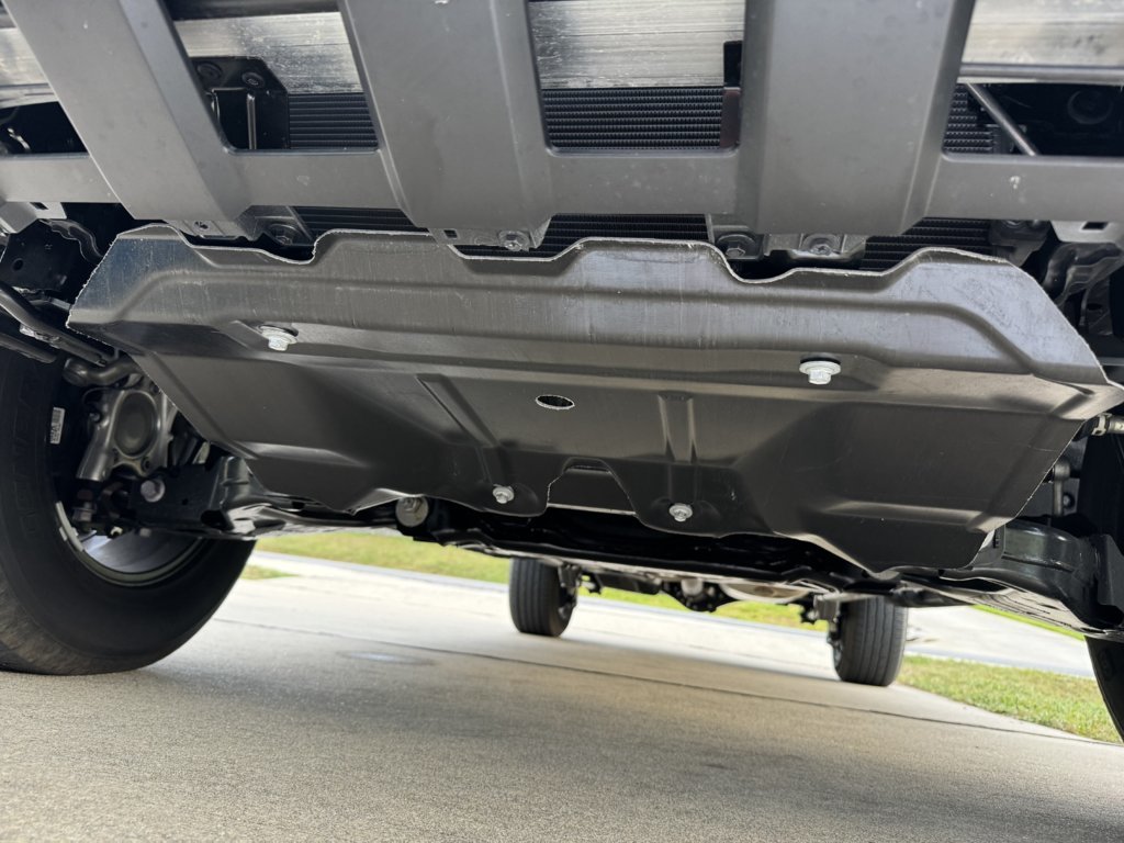

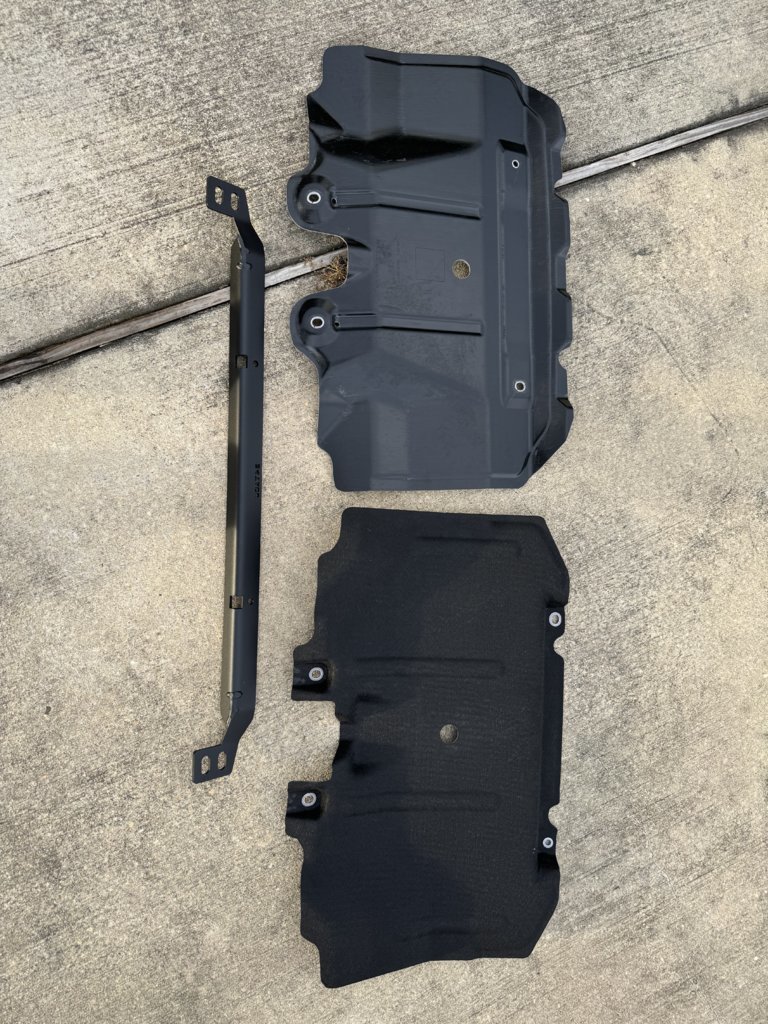

    In case anyone is wondering about replacing flimsy engine cover on the Sport/SR5's.
    I ordered the part used on the Off road trucks and the crossmember from RCI. Less than $200 spent on this and I should be good for the long haul. Plus it looks much cleaner.
    I know this will get hate from the folks that think I should spend many more hundreds for steel skid plates. You do you. I have a 2wd. I like the look of this, and have no need for a heavy plate. If I ever bottom out I am sure it will be on sand or Mud as I live in FL.
    The stock cover may last forever, but I have had issues with similar ones on my F150. This one looks worse than those did but it may not collect dirt and mud on top of it which led to the one on the ford sagging and eventually ripping off. (twice)

    It looks like you could overlay the felt one on the metal one and drill holes in the metal one where the felt one had them so you wouldn't need the cross member.

    the existing hardware works. RCI provides clip on nuts.

    you absolutely could. I like using the stock holes with the grommets since it has to be removed for every oil filter change.

    Yeah, I was looking at your pics. You wouldn't have the metal grommets giving strength to the plastic. Also, it looks like if you drilled holes, the 'skid plate' would not be flat up against the mounting holes, which would put more stress on the plastic. (I'm assuming this new plate is plastic, not metal.) I can get your skid plate locally for $132 and the RCI cross member will be $39, so $171 for this mod. When I took the air dam off a couple months ago, I was hoping to get something for around $200 to fix the issue. So, we're under budget!:)

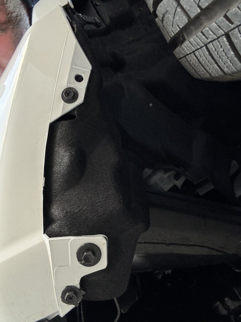

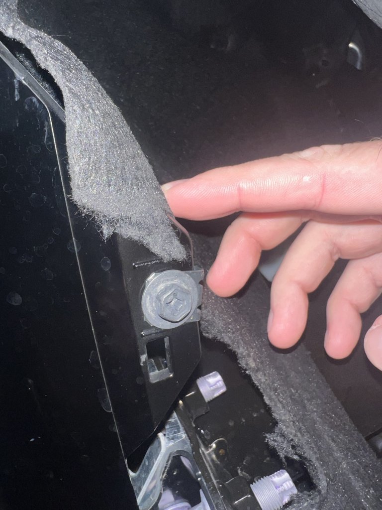

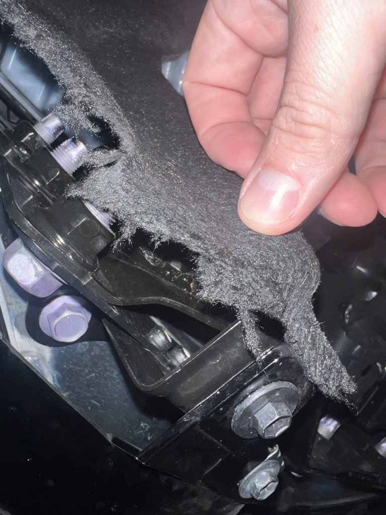

    Thanks for posting this. Still trying to find a solution for my driver's side wheel well that ripped.
    [​IMG][​IMG]

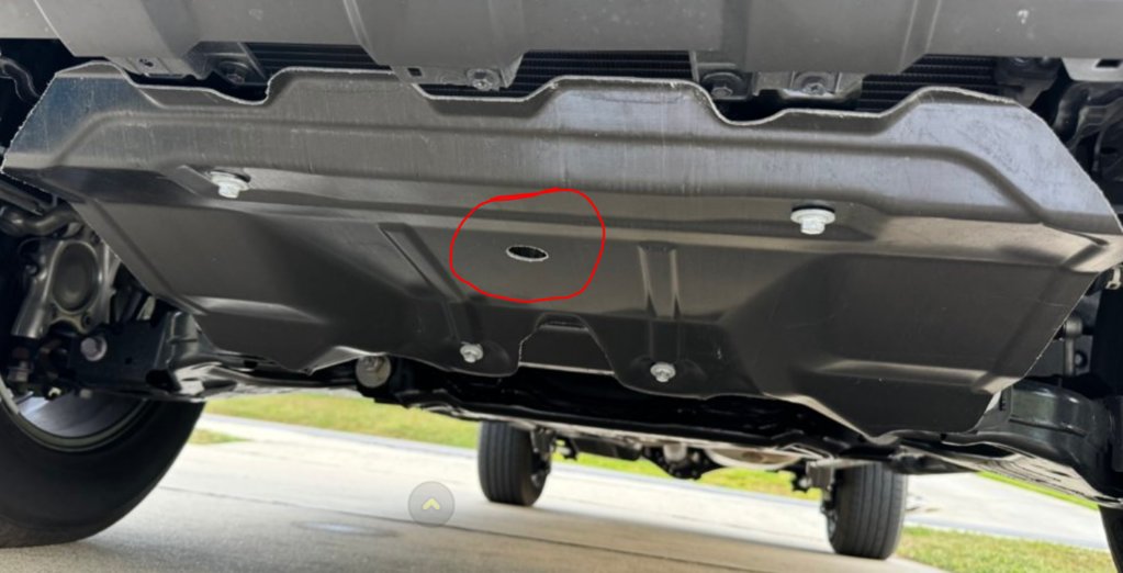

    Does this hole serve a purpose?
