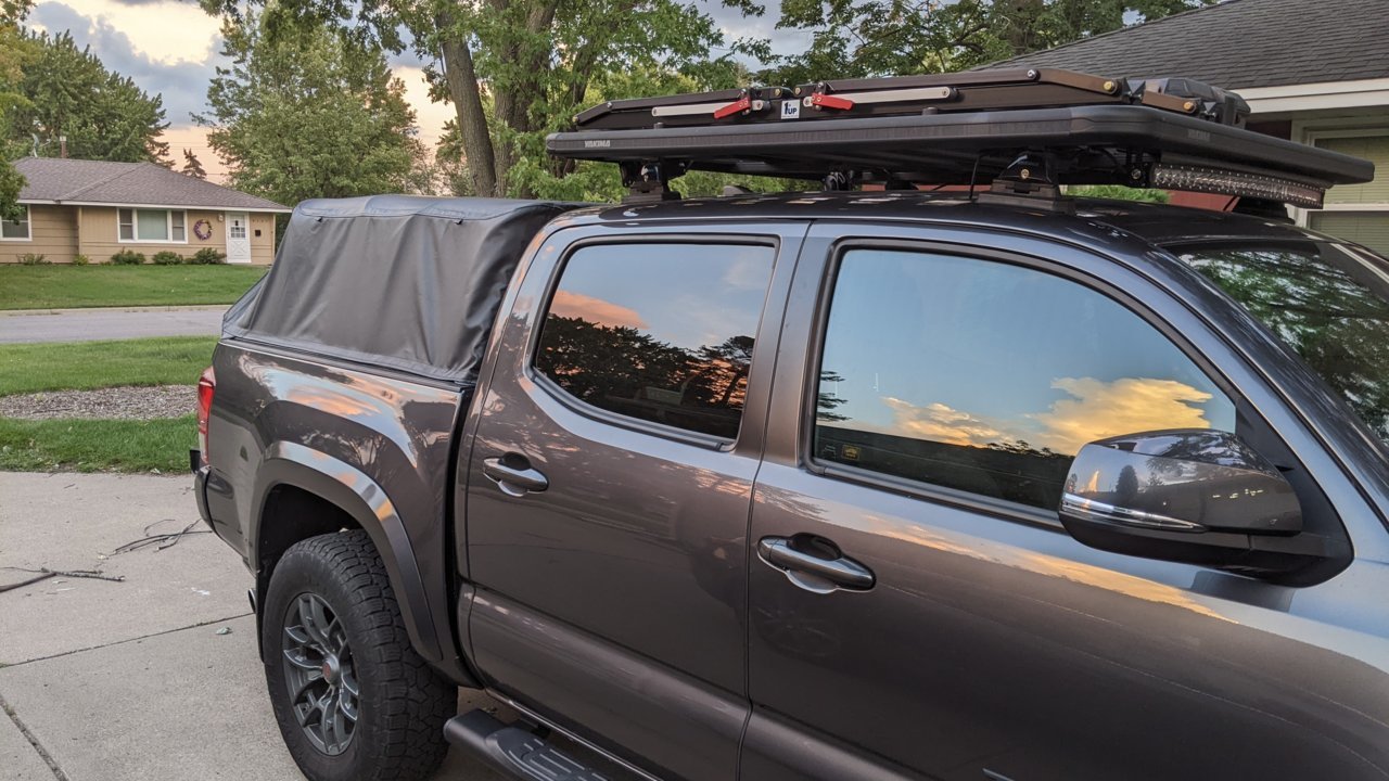

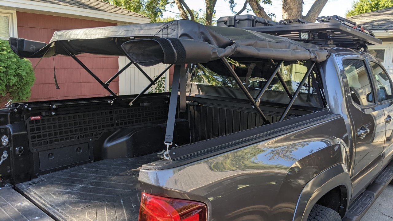

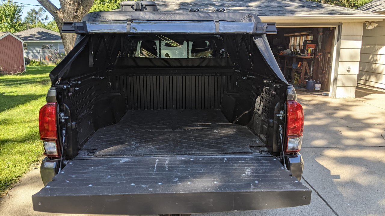

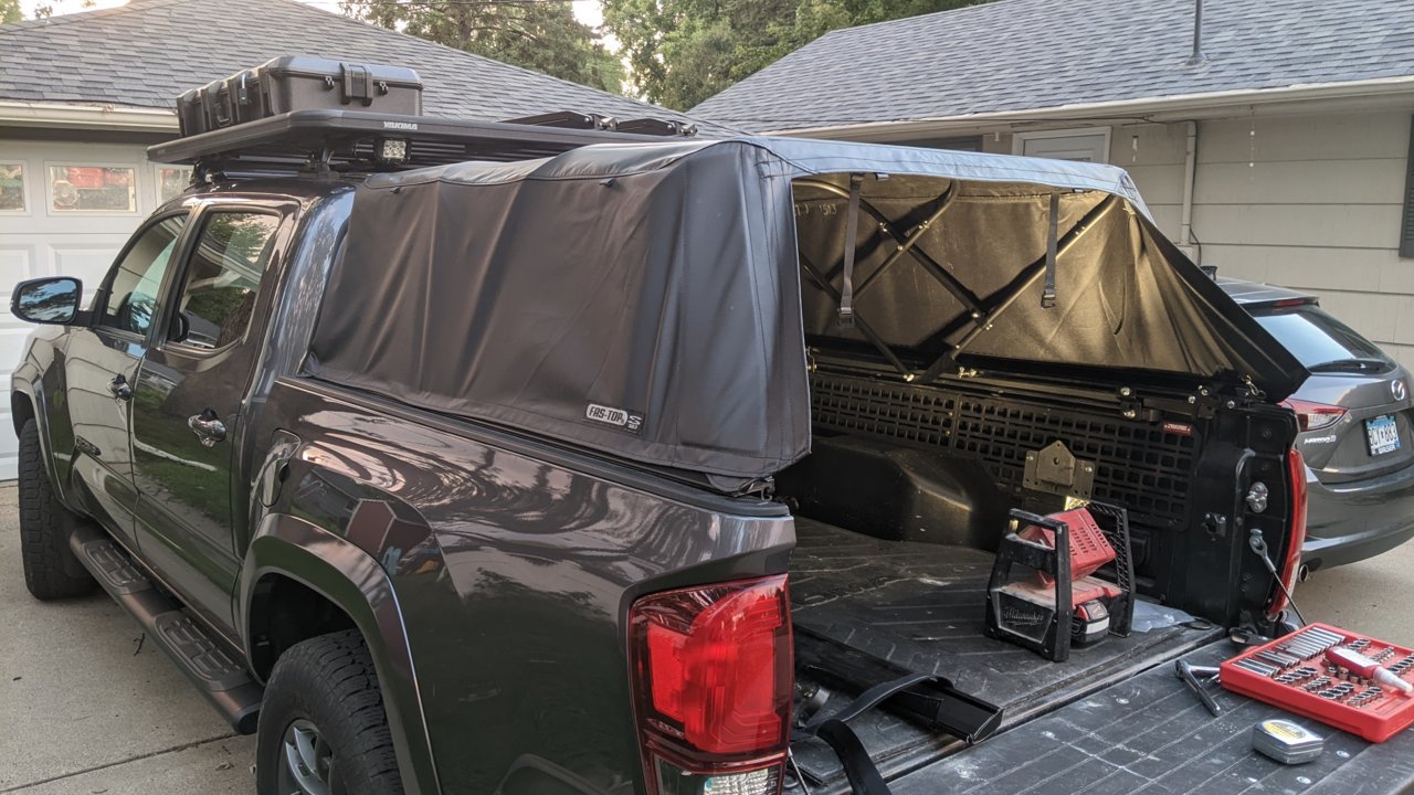

    Just got a Fas Top Solo Topper for my Tacoma.
    Installation took about an hour by myself. The major drawback of the Fas-Top vs the other soft toppers out there is there are no videos or real "how to" instructions for the Tacoma. So I took my time to make sure nothing got messed up.
    It was all pretty straight forward using the generic instructions that they provide. My only issue is the mounting clamps don't fit right, which might be because I have molle panels installed behind my rails. But it should be a simple fix with a vise and hammer to put a little extra bend in the clamps.
    The topper itself seems really well made.
    The windows are velcroed to the topper and have zippers to seal them to the side panels. The side panels attach to the rails via velcro.
    The rear window sits on top of the tailgate so on one hand you don't have to worry about it scratching your paint but on the other I'm willing to bet the ability to keep water out is no where near as good as Softopper.
    I went with this topper over Softopper and Bestop because the company that makes it is located in North Dakota and they claim the material is rated for the extreme cold temperatures the north gets.
    Tomorrow I will take more pictures once I get the rails fully installed.

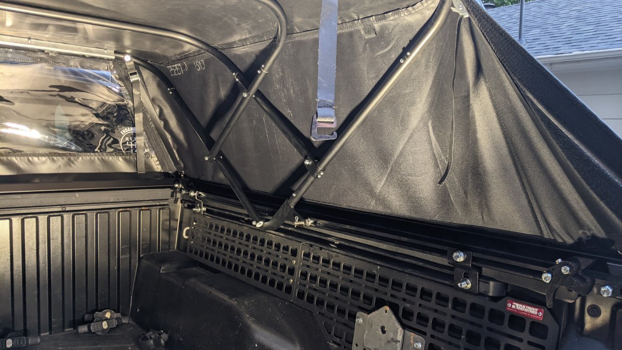

    So the rail mounts that I couldn't quite get right was a user error. I needed to fully torque down the bed rail bolts first then tighten the topper rail bolts after.
    The only modifying I needed to do was to clean out the excess powder coating inside the pivot holes, they didn't slide easily onto the pins.
    Folding it down is very simple and only takes a few seconds.
    The top material feels like a heavy vinyl similar to tonneau covers. The sides seem like some kind of canvas that has a little stretch to it which helps with attaching to the velcro on the rails.
    Each corner has a cam lock strap that you can pull on to adjust the tightness.
    Getting the side panels to look nice is fairly easy, depending on how much of a perfectionist you are, since they attach via velcro instead of snap buttons. But that means each time you take it down you will have to perfectly line up the velcro the next time you open it.
