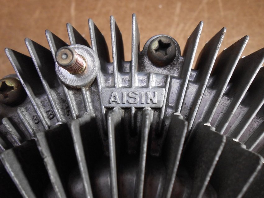

    I have found the same in my research. Supposedly only one of the 5VZ options is available these days, and they are differentiated by the color of the hub.
    Thanks for the help.
    Thats some great info. Fan clutches are such neat mechanical devices.
    I purchased an aftermarket Hayden fan clutch from my local auto parts store. Hopefully it doesn't suck, otherwise I may try and give my old one a little love. Unfortunately I couldn't wait for a new Aisin one to arrive.
    One thing to note however, is that my old fan clutch, while much larger than the cheap Hayden one, doesn't say Aisin anywhere on it. I would very much like to crack it open.

    Yes I believe the "standard" V6 clutches were superseded to the "heavy duty" version. They came OE on many equipment packages and was not part of the Toyota hitch kit.
    OE, 99, V6, heavy duty
    I have 3 (don't ask), they are all the same.
