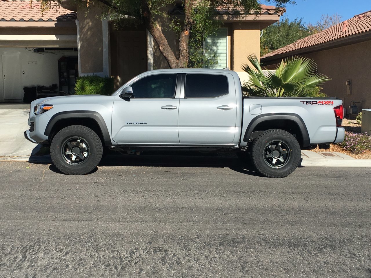

    Can you post a pic with the tires ????? And is your truck lifted ????

    Here ya go...stock suspension, but I’ll be lifting it on Monday.

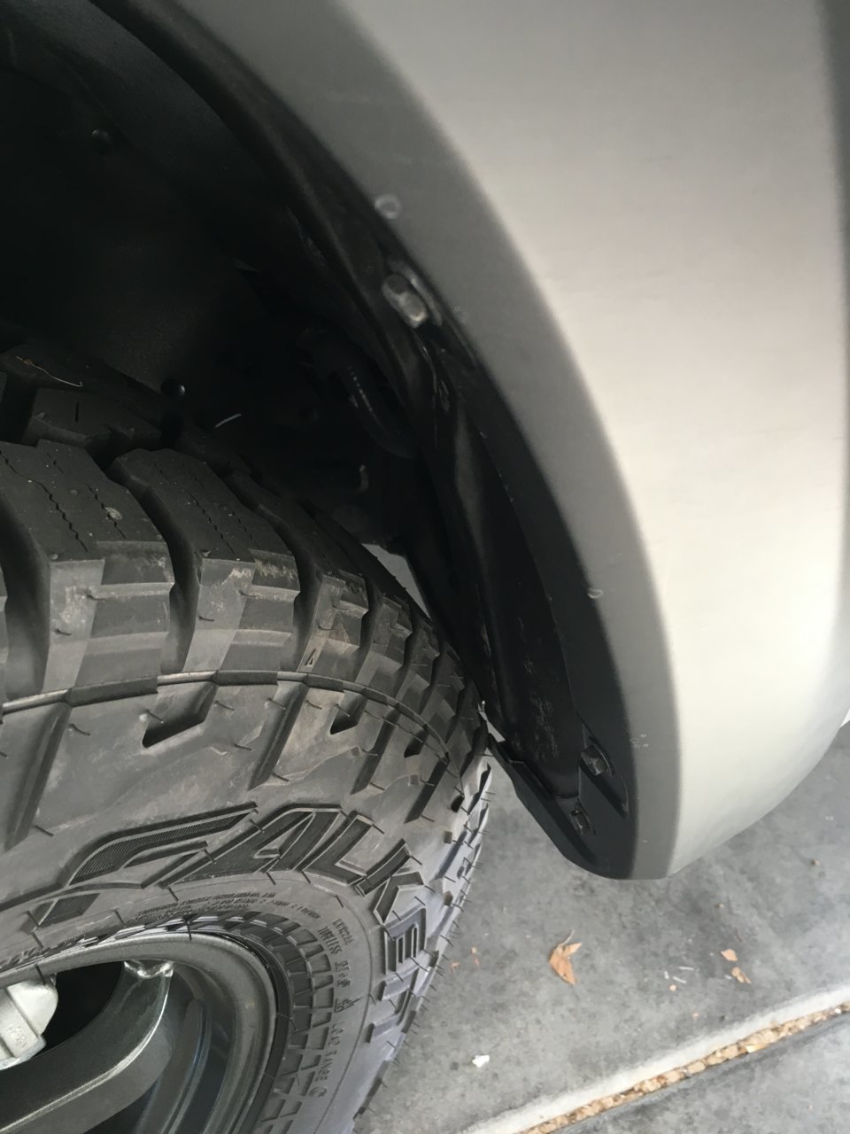

    looks good! are you rubbing with that size without the lift? everyone says 285/70 rub but does the 275? thanks

    Thanks Mike! It was rubbing in reverse and at about 50% lock on the driver side with the castor at about 2.5. I’m not sure if getting the castor above 3 would’ve avoided the rub or not. UCAs cleared with no prob with my wheels having -4.5BS 30D671AD-4FCA-4FB3-AABC-7952D67182AE.jpg2F3D6EDC-FEBC-4653-89A3-EEAE6DE52ECB.jpg

    Im now running a lift and that has gotten rid of any rubbing whatsoever.

    Thats not bad just a little lift would make it clear probably. Ive got my lift sitting in the garage just deciding on wheels and tires still. Ive been set on the falkens just not sure what size i want to do exactly 285/70/17 and 265/70/18 are the two falken I have been thinking about, still p rated and light weight. The 275 could be a winner though because its an Lt but c rated so and looks more aggressive than the p rated.
    Are those rotiform wheels?

    Yeah, these LTs have that aggressive look and look even better in person. I was thinking of going 285, but didn’t want to deal with the possibility of having to cut and chop. I’m glad to have gotten these Falkens in 275. Wheels are from FN Wheels:
