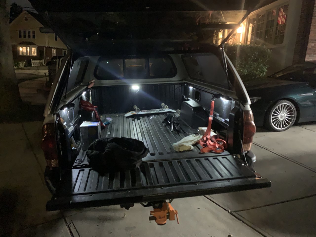

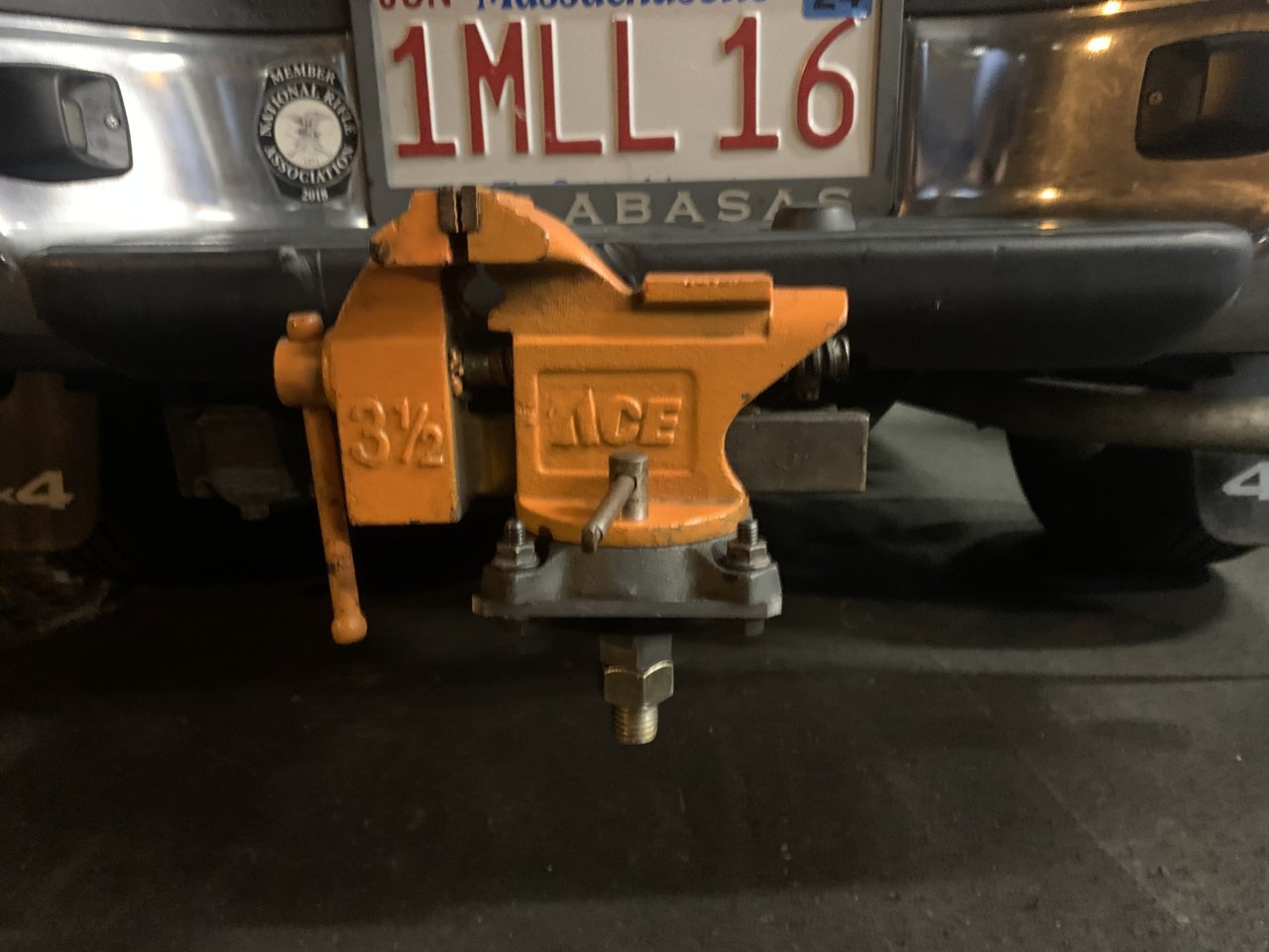

    @whatstcp Thank you for the advice! I’ll take that into consideration, do more research, and test my battery.
    As far as refraining from modifications to the truck I have a problem with keeping things stock and always find something to fix, apply, or upgrade as an engineer . It’s blessing and a curse. As much as the things I’ve done to my truck might make it seem I’m a cheap b******. The lighting and electrical I’ve recycled from past projects and my schools engineering lab dumpsters with minor trips the the hardware store.
    Thanks for taking the time to respond to my post!! :)
    Here’s a couple images I thought I’d share.
