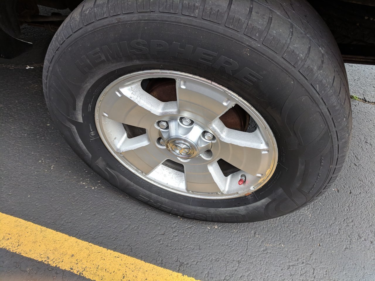

    So 2006 factory rims the silver isw peeling off and leaving behind a quite ugly steel rims. Not looking to splurge for wheels right now. Should I plastidip or paint. I know neither is a perfect solution. Looking for the best option between cheap options. Looks like someone sprayed them before for what it's worth. Only uploading 3 since I'm lazy 4th is about the same. IMG_20180622_153432.jpg IMG_20180622_153415.jpg IMG_20180622_153355.jpg

    Sorry to tell you... that does not look factory. The factory alloys are machine aluminum and they have a powder coat clear over them.
    You've got a couple of options...
    1. leave it alone and say F it, its a truck ( Cheapest )
    2. Plasti Dip it... good from far, far from good but YMMV ( Still Cheap )
    3. Powder coat it... may end up costing more than the rims ( Kinda Expensive )
    4. Buy new OEM Rims ( Expensive/ Retarded )
    5. Buy new Aftermarket Rims ( Expensive Investment )

    Plus in picture #1.... I see a sag in the paint which tells me someone was sleeping while painting or someone who doesn't know how to adjust their paint guns..

    Thanks when I looked closer I saw that too. I just assumed they were factory. Guess I shouldn't have used that terminology. Yup I agree someone painted some rims. I appreciate the advice .

    There are companies that refinish old wheels. Have no idea about cost, but its cheaper than new.

    Sand them up and plastidip them.
    Mine are oem but started peeling the clear coat. I just sanded them and plastidipped them.
    Its been 3 winters +.....surprising how long plastidip lasts.

    My wheels did the same thing. Road salt gets under the factory finish. I wire wheeled it to take the flaking off, the underlying aluminum oxide (white powder) and scuff up the remaining clear coat. Looks great from 5 feet.
