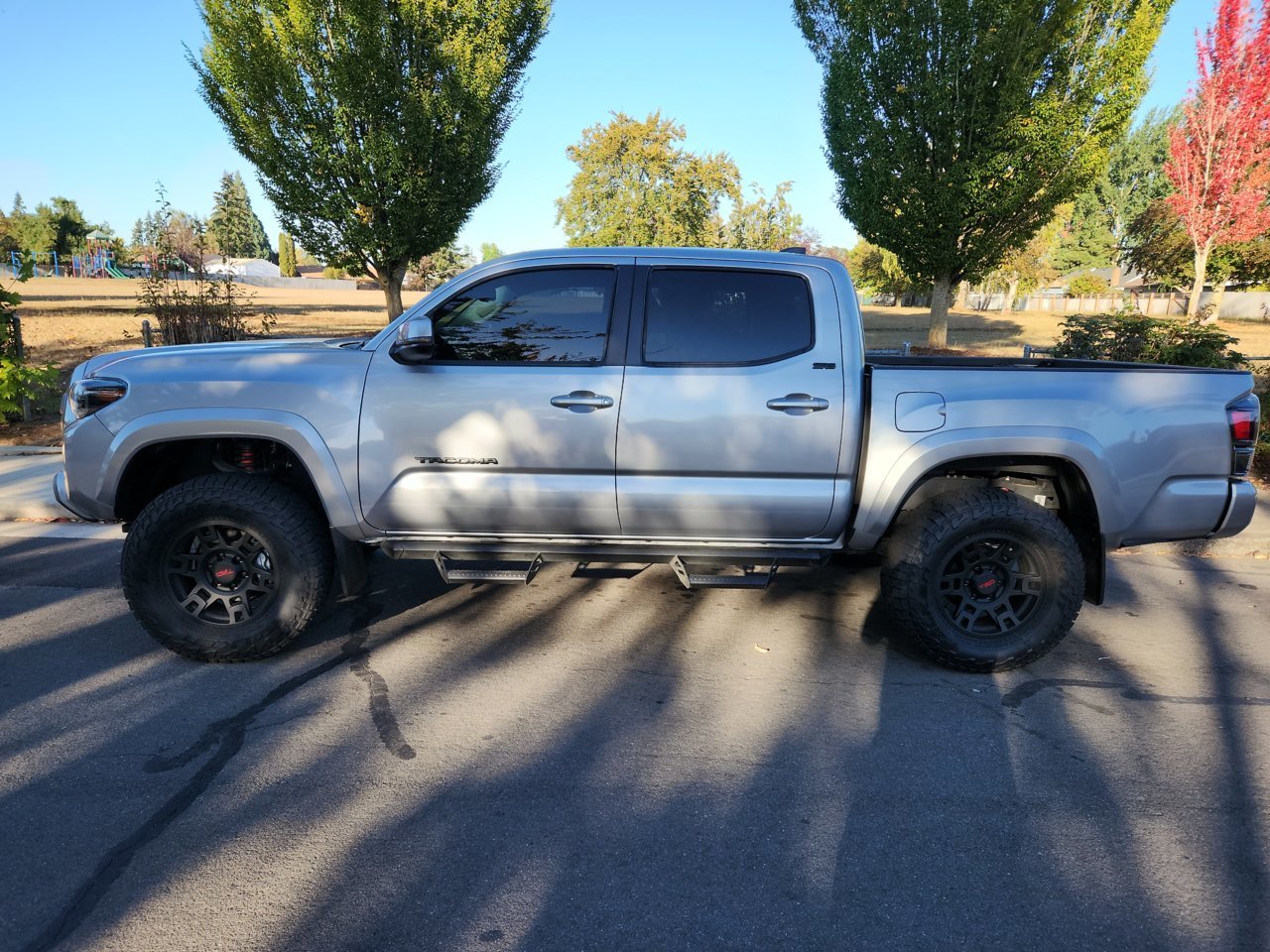

    Different states have different laws. Here in OR you can't have fog lights on lifted vehicles because they blind oncoming drivers. But if you just ask them to leave them in, like I did, they will probably just leave them in for you.
    I have the lift kit. I like it. No regrets.
