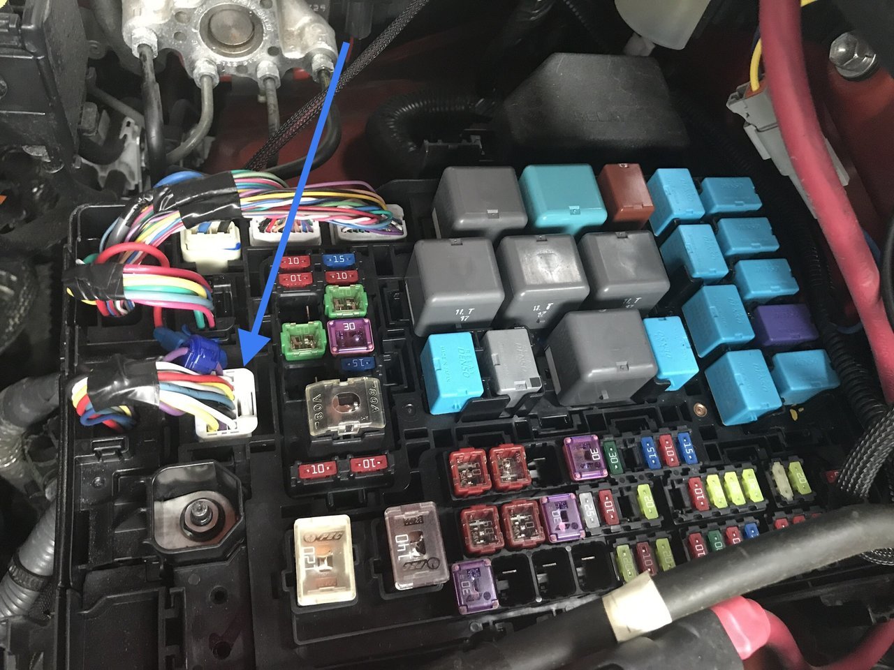

    First, find the under hood fuse box. This should be easy. If not, stop now! :rofl:
    I’m pointing at the wire connected to my Switch-Pros.
    Then, find the EA1 connector. It’s the white one closest to the front and passenger side of the truck.

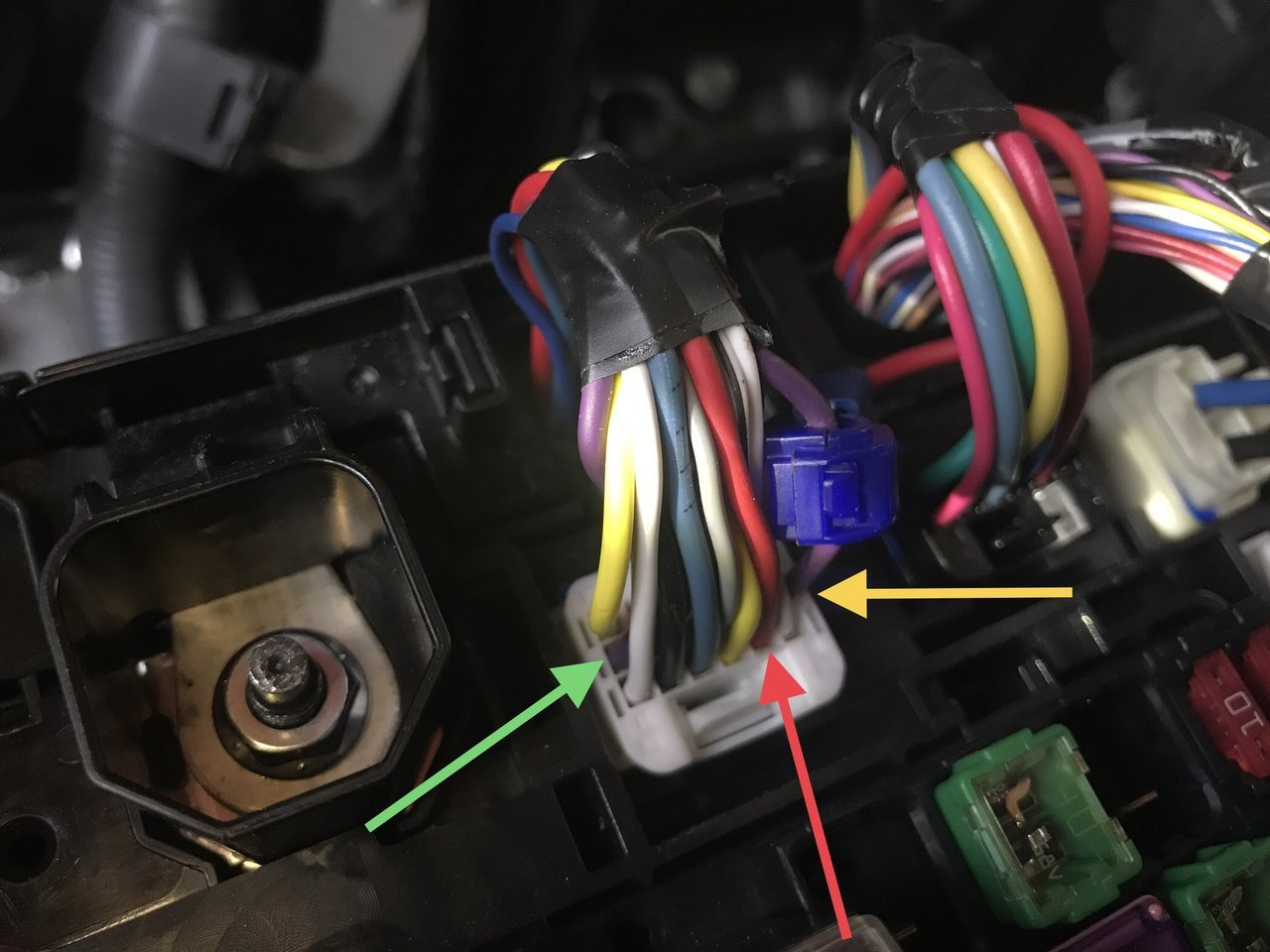

    Then, tap a wire. I used some red wire I had laying around, and a 3M t-tap. These things are my favorite way to tap a wire. Use whatever method you like.
    IF YOU HAVE AN AUTOMATIC AND WANT TO ENERGIZE THE RELAY COIL, tap into pin 5, the red wire with the red arrow in my sketch. If you do this, do NOT attach any other devices or lights to the wire you are adding (other than a switch connected to battery voltage) or else you may damage your vehicle in a very extenuating circumstance. The benefit of this route is that you do not need a relay of your own. This method energizes the low current side of the factory reverse light relay.
    IF YOU HAVE AN AUTOMATIC AND WANT TO ENERGIZE THE REVERSE LIGHTS DIRECTLY, tap into pin 7, the red wire with the green arrow in my sketch (mine is purple, 6MT is a different color on the same pin). You will need to add your own relay and/or switch capable of handling the full amperage required by the circuit (fused at 15A). This method energizes the high current side of the factory reverse light relay.
    IF YOU HAVE A MANUAL your choice is easy. You have no relay. Tap into pin 5 (red), 7 (purple), or 12 (purple) (any of the 3 arrows in my sketch). They are all bussed together inside the fuse block anyways. I chose pin 12 because it was closest to the wire exit point and thus the neatest. As with automatic above, you will need to add your own relay and/or switch capable of handling the full amperage required by the circuit (fused at 7.5A this time).
    Then, route your wire out of the fuse block area and to the relay/switch of your choosing. There are a few pass through points, all you need to do is stuff the wire through, and there is plenty of room. If there is tape in your way, just use a coat hanger or screwdriver or something to help the wire find it’s way through. The wire is running through a plastic wire funnel thing. It should pop out the bottom passenger side of the fuse block alongside the factory harness. This is how I did mine. I did my best to maintain a near-factory and very clean install.
    Connect this wire to your relay and/or switch you chose earlier. Supplying +12V to this wire will energize the circuit and turn on your reverse lights. I connected mine to my Switch-Pros.
