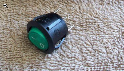

    Agreed, no problem to run a relay - just not very useful as fogs only work with low beam and shut off with high beams.
    What do your switches look like? Do you have any dummy blocks in the dash?

    I have ch4x4 switches for everything except the fogs. And both the light bar and ditch lights have a complete plug and play harness. I was just trying to avoid having a bunch of wires coming off the battery for now since the winch will need to get wired as well. I may wire them up with the harness or I’ll just leave them until I get the switch pro. I have a paranoid fab mount with the stuff to go that route in the garage too. I spent a lot of time looking at how other people have done things and just snow balling on how to tame my OCD with their already great ideas. The big thing for me is cleanliness as well as trying to avoid permanent alterations. OCD at its best...
