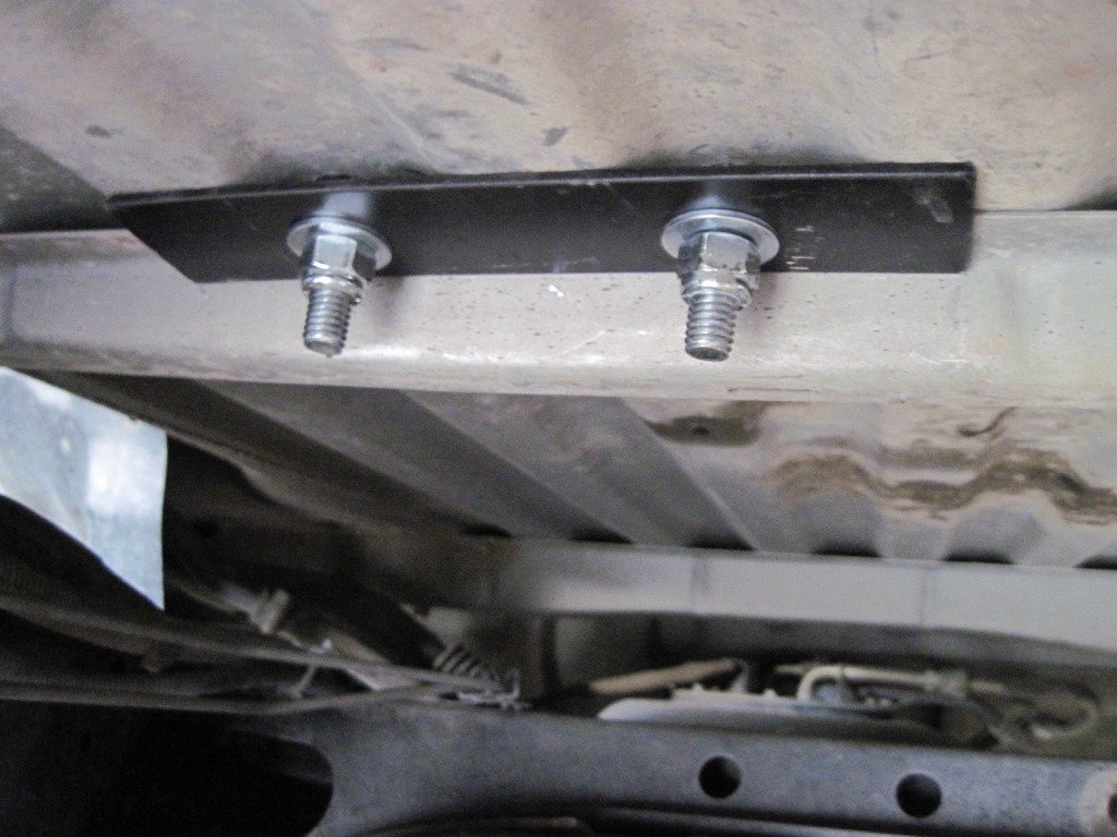

    whatever possessed me... here it is
    I welded the original small feet to three 5" X 5" plates
    so that they would span properly the ribs in the bed's floor
    ( ^ the original Ftech feet may have been for some other truck ? ) :notsure:
    backing plates were made to span the ribs correctly underneath.
    Nylocks were used to secure the bolts
    put some rubber backing on each mount plate...
    so's incase they corrode some... the don't stain the carpet terribly
    was really a simple thing, with little fab work involved
    but it should minimize the clutter of using straps to hold chit
    so that counts for sumthang
    pics of the final...
