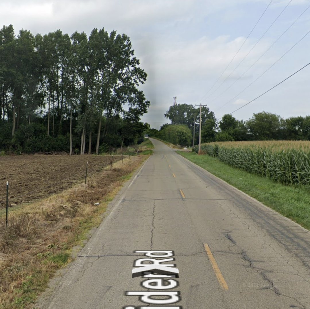

    Road tests (same locked camera settings). This spot was chosen because at the very extent of the reach of the lighting the roadway becomes tree lined and curves up and to the left. Any improvements in lighting would be obvious here.
    Halogen
    LED.
    In short, basically worthless. No better at best, less distance lighting at worst. Light volume side to side did seem to improve some on narrow tree lined country roads but no observable improvement in distance lighting
    It's worth noting that the base of the led is adjustable (and complete crap imo). I initially set the bulb with the emitters firing directly to the sides. I also took a run with the emitters facing up and down. No improvements in distance from the up/down orientation but possibly reduced lighting to the sides. No benefits from the up/down orientation.
