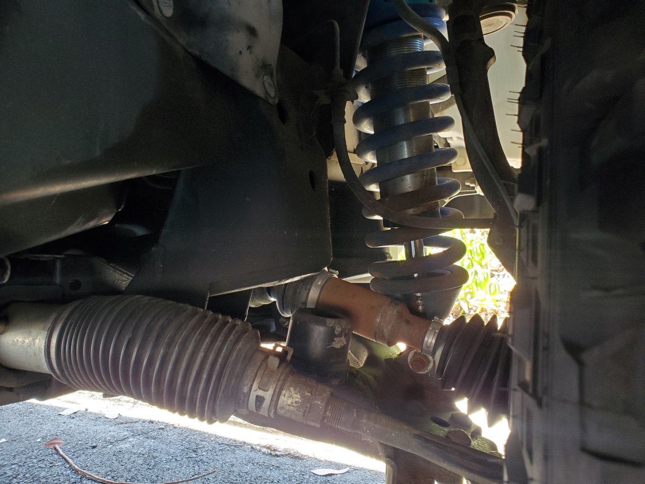

    @Cole@1234
    When I first bought them, back in 2020 -
    First installed, just before putting them through the paces -
    After many wheeling sessions, a good +15k miles at this point -
    Taking advantage of their added droop compared to stock -
    Hard to pin point when exactly the boots ripped (on both sides) but I'd venture to say around the 7k mark.
    With the boot torn, you can see the assembly and how it extends/collapses -
    Pushing 20k miles, and I still ventured out in sand, snow, water, etc without fail -
    Then I got rid of the rig.
    I'd say the CV axles had a good +25k miles on each, with a majority of them being with torn boots.
    Being exposed to water, mud, sand, snow, and whatever else I dunked my 4R to couldn't have been good for said axles but they never clicked, rattled, or fail apart and/or broke. You can ask those that have gone wheeling with me, I was no stranger to the skinny pedal either.
