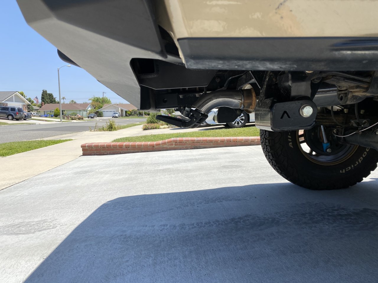

    ***Update***
    Problem: Wasn’t happy with the volume of the exhaust. The tone is great, low and burbly
    Solution: Made a few changes and it was a night and day difference…but I lost that aggressive low and burbly tone. It’s very quiet now.
    I ended up installing a vibrant ultra quiet resonator in the stock muffler location. I recently had some shackle hangers installed and a cross bar in place of the spare tire. I had them tuck the borla 14” muffler in the spare tire location and had them dump the exhaust at the bumper.
    Results: I would say if the stock exhaust was a 3 sound wise on the 10 scale. After replacing the stock muffler with the borla 14” muffler it went up to an 8. Very loud and aggressive with a low burbly tone. When we swapped out the borla 14” muffler for the resonator and moved the borla 14” to the spare tire location and did the dump below the bumper the volume went back down to a 5. However at WOT now it sounds more like a sports car with a turbo. Kind of a sporty rasp but very refined not as loud and obnoxious as the borla by itself. It’s hard to explain.
    I’ll try to get a video to post but if definitely doesn’t sound like a v6 taco anymore. It sounds more like a car.
