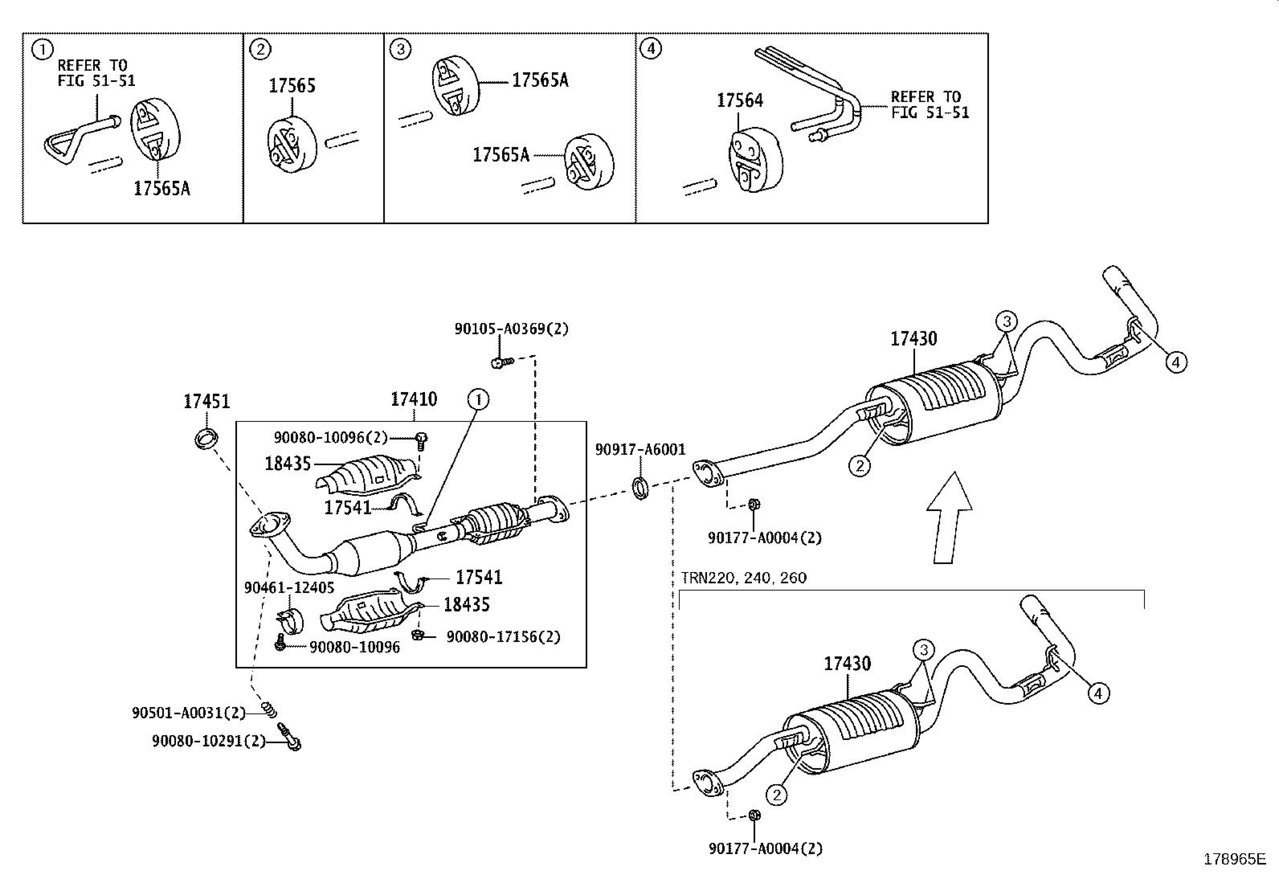

    Hello,
    I purchased the TRD exhaust for my TRDOR 2017 MT. The current fittings are in rough shape. I bought the truck used, so since my purchase, I have tried to keep everything clean and rust-free (I live in the northeast). Although there is little to no rust anywhere on the vehicle's underside, the fitting below has rust.
    I'm guessing for removal, I would steel brush it, and use PB blaster to get the bolts out as clean as possible. I would obviously need new hardware when installing the new exhaust. I looked on Toyota to get a part # for the bolts, nuts, etc. However, if they are just going to keep rusting, should I get hardware elsewhere? Does anyone have experience with this?
    Below is the diagram.
    If I use the OEM hardware... I'm assuming i would need these... Please correct me if I'm wrong.
    https://parts.prestigetoyota.com/p/69368594/90177a0004.html
    https://parts.prestigetoyota.com/p/72020072/90105a0369.html
    Thanks, any insight is appreciated.

    Sounds good, guess I will try to match up the bolts to what I pull out, or is there info on the exact size?

    any idea on size? Contacted local parts dept at toyota and they had no clue, said they would "get back to me". usually, i would take the bolt/nut off and match it up at the hardware store, but with the rust idk if i will get an accurate matchup.

    My issue isnt really taking them out, not worried about that, rather getting the right size replacement bolt. I did not want the toyota hardware as they will re rust, but if size really isn't a big deal then i will try to match it as best i can with a stainless steel bolt/nut. Just didnt want the system to fail because of something dumb like using a wrong nut/bolt combo...

    perfect, Toyota parts center near me found the correct bolt and nut, its $7, going to get it and use it as a reference to buy a new stainless bolt/nut set. thanks for the advice everyone. I can also share the correct bolt nut size too when I get the new set because Toyota had no idea about size.
