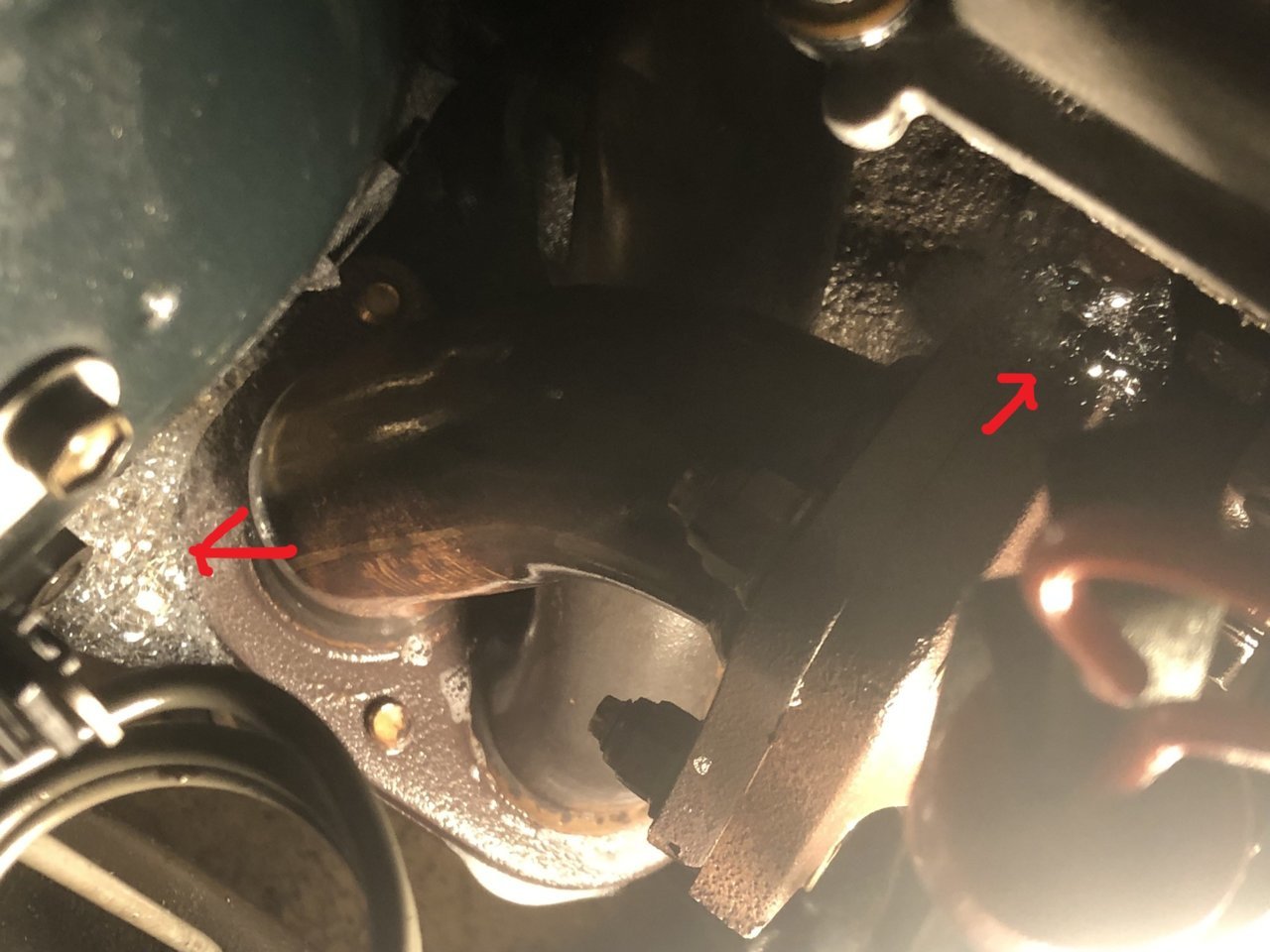

    I checked my exhaust for leaks with an air blower backflow and spraying soapy water everywhere. The flanges against the engine are good, as far as I could access from the top anyway. 3 flange junctions after that are leaking air as indicated by my soapy bubbles:
    1. Top of flange junction closest to the engine on passenger side
    2. Side of next flange junction exiting engine bay
    3. Top of flange junction just downstream of cat. (the one just upstream of cat is fine)
    No cracks visible. All downstream of that is good.
    Does it look like a fairly easy DIY job with this kind of putty?
    https://www.permatex.com/products/s...haust-repair/permatex-muffler-tailpipe-putty/
    The flanges are pretty rough with surface corrosion, so I don't know how much I'll be able to clean up the surface, and don't even think about removing those corroded nuts to try to remove anything to clean it up. The exhaust pipes look fine.
    See bubbles below.

    The nuts and bolts by the cat are too corroded for me. The other ones maybe. But the diagrams don't really list all the nuts and bolts, and they have a few listed that are discontinued, and I can't even find the first flange in the diagram. It's right by the manifold on the passenger side but isn't shown.
    https://parts.toyota.com/a/Toyota_1...-2WD/_50016_6725139/MANIFOLD/675460-1701.html
    https://parts.toyota.com/a/69362386__6706979/EXHAUST-PIPE/671450-1702.html
  4. Apr 10, 2023 at 10:48 PM
    JustADriver
    JustADriver [OP] Well-Known Member
    Mar 27, 2011
    #53838
    652
    1996 Tacoma 3.4L V6 2WD 5-lug AT 5VZ-FE
    Ok, it looks like for the spots in the engine bay these are all nuts and studs on the exhaust flanges and are probably in removable condition. I'll order the gaskets and a ton of nuts. Hopefully I'll be able to remove enough parts without too much trouble to get that section off the studs and not end up having to remove the exhaust manifold itself or something down at the cat where things are corroded. I'll maybe deal with the leak by the cat later on.

    Are you guys saying even the ones in the engine bay should be terrible to remove? I actually tested two nuts at the manifold and I was able to break them free dry. But I'm not sure offhand about being able to get an angle with the breaker bar on all of them. I'm not so much concerned with the leak by the cat (number 3 in the diagram below) where the nuts are badly corroded.
    But again I don't know how much exhaust I'm going to have to remove just to remove one or two pieces, with all the studs I have to get them free of. Any experience with taking pieces of the exhaust off on this? I'm hesitating and might have a shop do the entire set of exhaust gaskets if I can't get all the nuts off that I need to for leaks 1 and 2.
    Leaks 1, 2 and 3 below. The part in the bottom right of the first pic is the exhaust crossover. Its position in the diagram threw me off at first because it connects to both left and right manifolds.

    Double check your exhaust.
    There is a version where location 2 has a single gasket. The two crossover pipes converge into a single pipe at the flange.
    Location 1 has a counterpart on the drivers side as well. You'll need to undo that flange / connection to be able to move the exhaust enough to get the passenger side gasket out.
    Yes, location 1 bolts are the knuckle busters. If you're able to get those out easily, then go buy a lotto ticket (and share the winnings).
