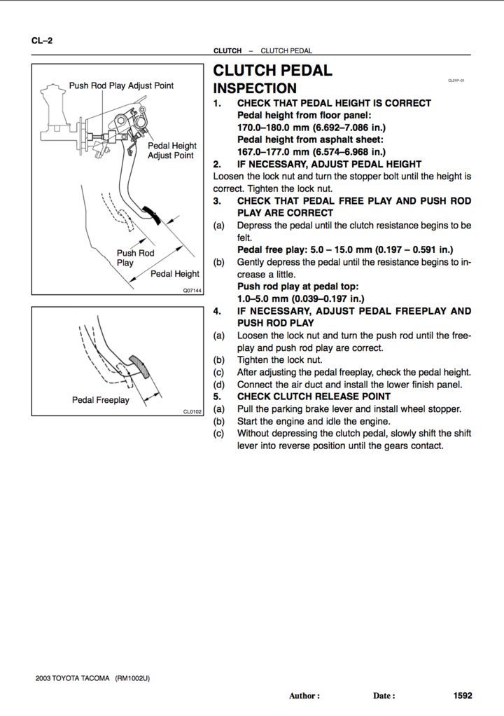

    I don't have a 2nd gen FSM but the 1st gens have threaded adjustments for pedal height and rod free play.
    Hopefully someone will post the proper illustration, untill then I hope this helps.upload_2020-10-2_1-7-10.jpg
    KanakaRebel[OP] likes this.

    So I’m guessing that dictates how much free play the pedal has? I’m still trying to figure out how the pedal developed this problem to begin with. The nut is still fully tightened, doesn’t look like it backed off at all.
