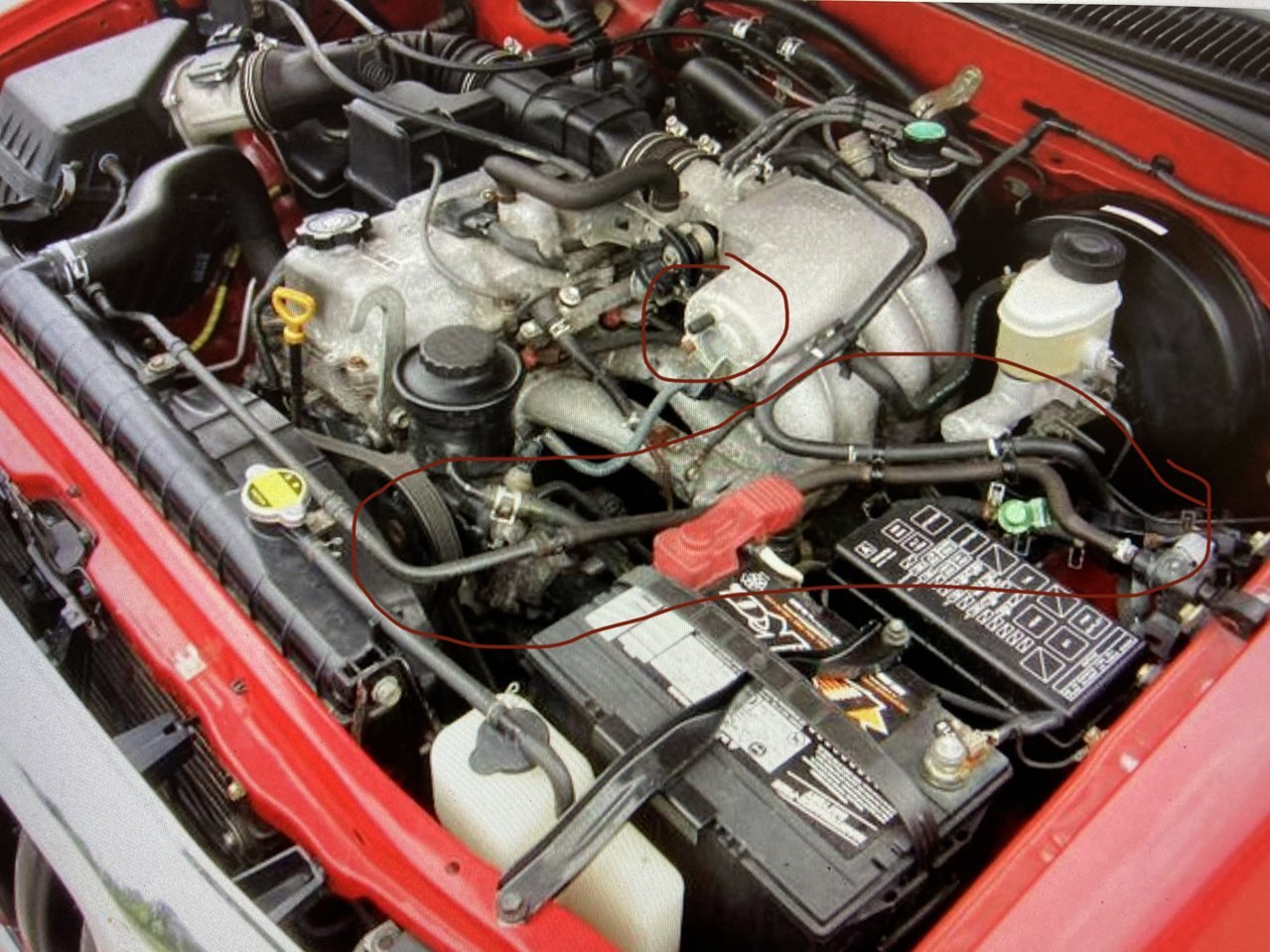

    Here is a picture of what the engine bay is supposed to look like. I highlighted the CCV VSV.

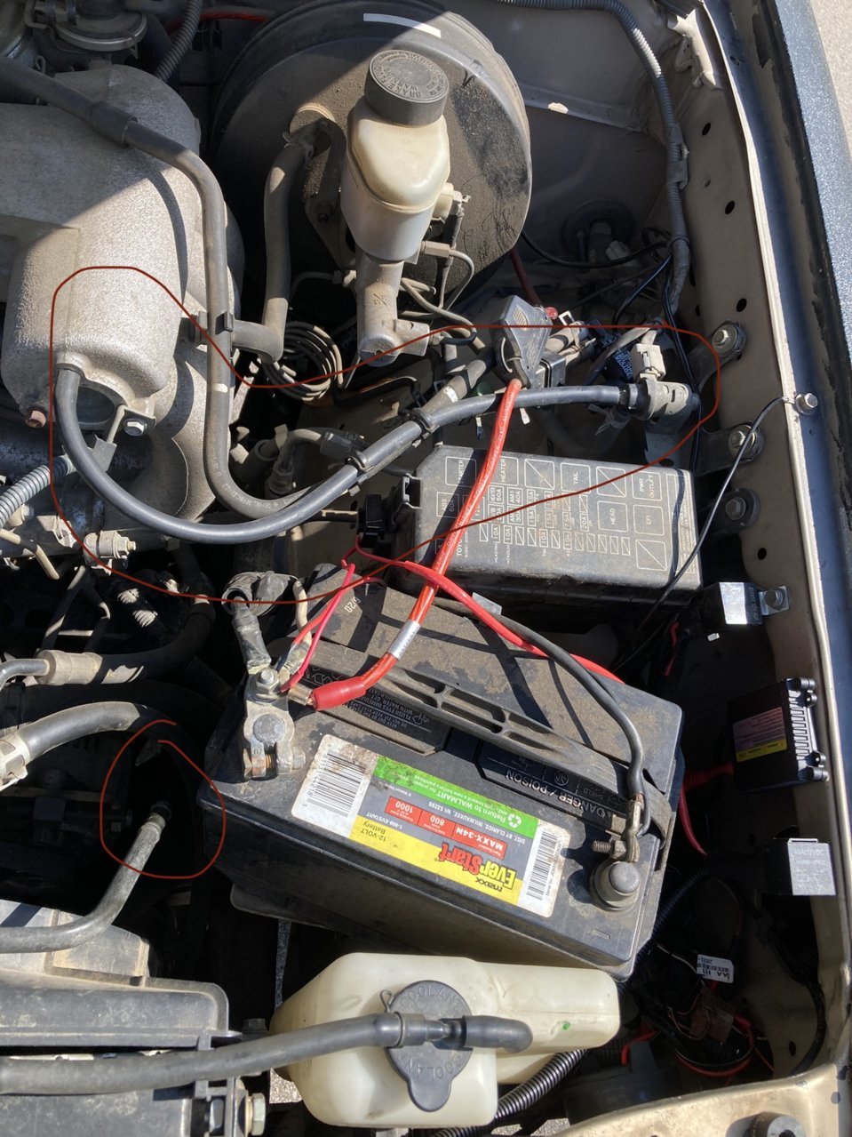

    Here is a picture with my own engine bay. As you can see, there is no hose connecting the CCV to the air intake. I ordered the right hose and a valve port cover for where the hose is connected now. Does anyone think this could be the root of the issue?

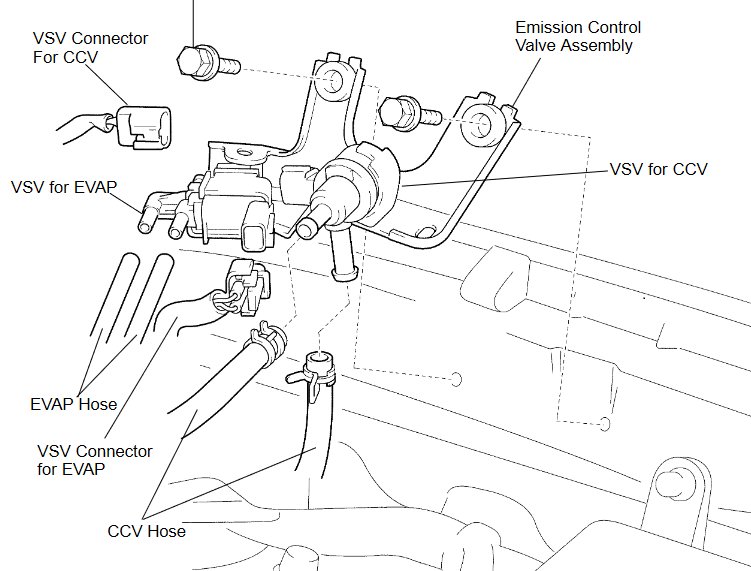

    I had a similar EVAP problem with my '04. Perhaps this diagram may help. The one CCV hose goes to the air intake manifold and the other should go to the throttle body. The hose was in the correct location

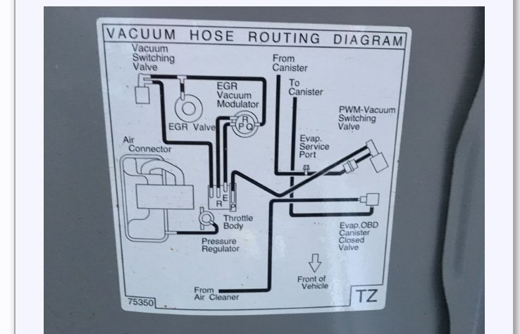

    That diagram shows different than the one for my Tacoma. Here’s what I’m working from:
