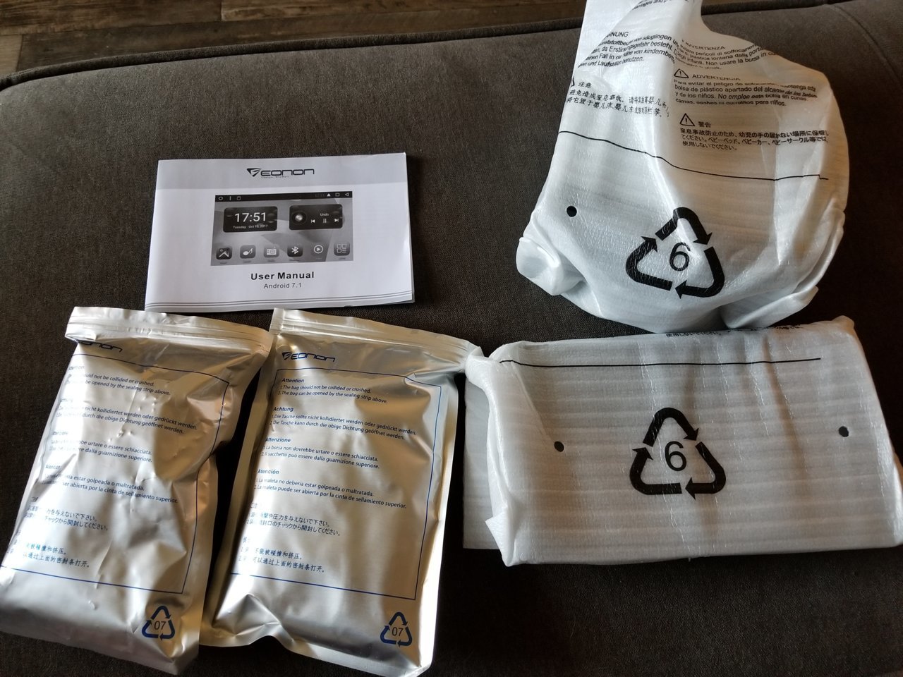

    What's up guys? Just received my new Eonon 10.1 inch deck. I believe this to be the latest edition, Android 7.1 2gb/32gb. I ordered mine on Ebay, from a seller in California for $312 shipped. Arrived here in Vegas in 2 days. Here's some unboxing pics, box and packing quality seems is perfect.

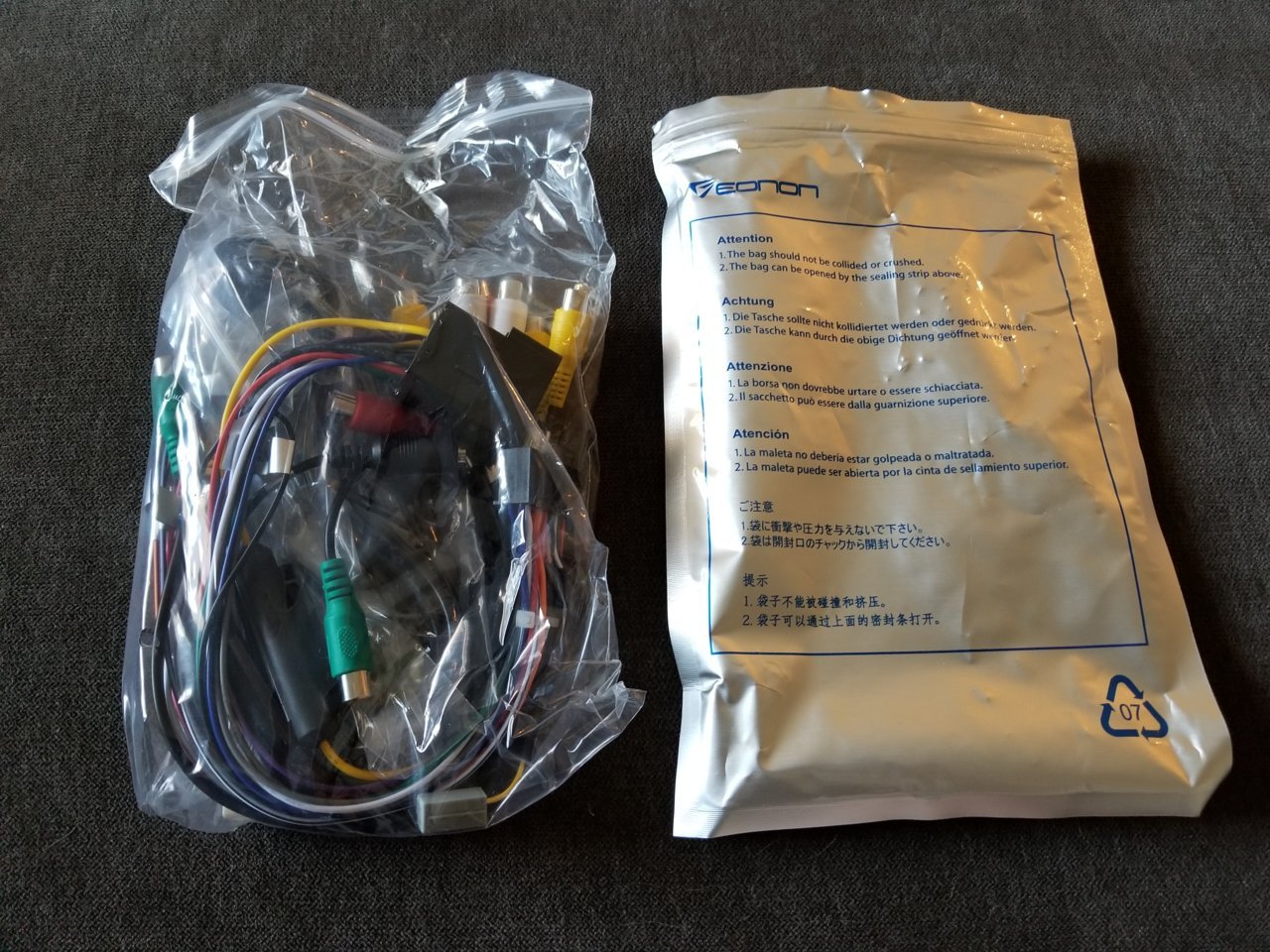

    This thing has every type of connection you can think of. Multiple forms of video input such as HDMI and AV inputs, 2 USB ports (one for a dash cam). 2 subwoofer outputs, front and separate rear RCA outs, a monster mic in (even though the face has a mic), steering wheel control (single wire), GPS antenna, WIFI antenna. The wiring harness for the deck came wired to a plug. I bought a toyota wiring harness from FRY's here in Las Vegas for $2.45. (they price match internet pricing). So i cut the wires from the back of the black plug and used the manual to see the wiring diagram for the head unit, connecting the two with nylon butt connectors. My wiring was different than I had expected. For example the red wire was not the constant positive, the yellow was. So if you are buying this deck I would carefully check the wiring pin numbers in the manual. I have only driven with it for about 45 minutes but it seems to work perfectly. Boot up time is about 1 minute, but it has a shutoff delay that you can set for up to an hour so the unit will 'sleep' instead of completely shut off when you shut the car off for short periods of time, like while getting gas. Sound quality is decent out of the box so I am sure that with some tuning, and subs Im going to put in next, it will sound great. Ill post some pics of the installed deck here in a few minutes.

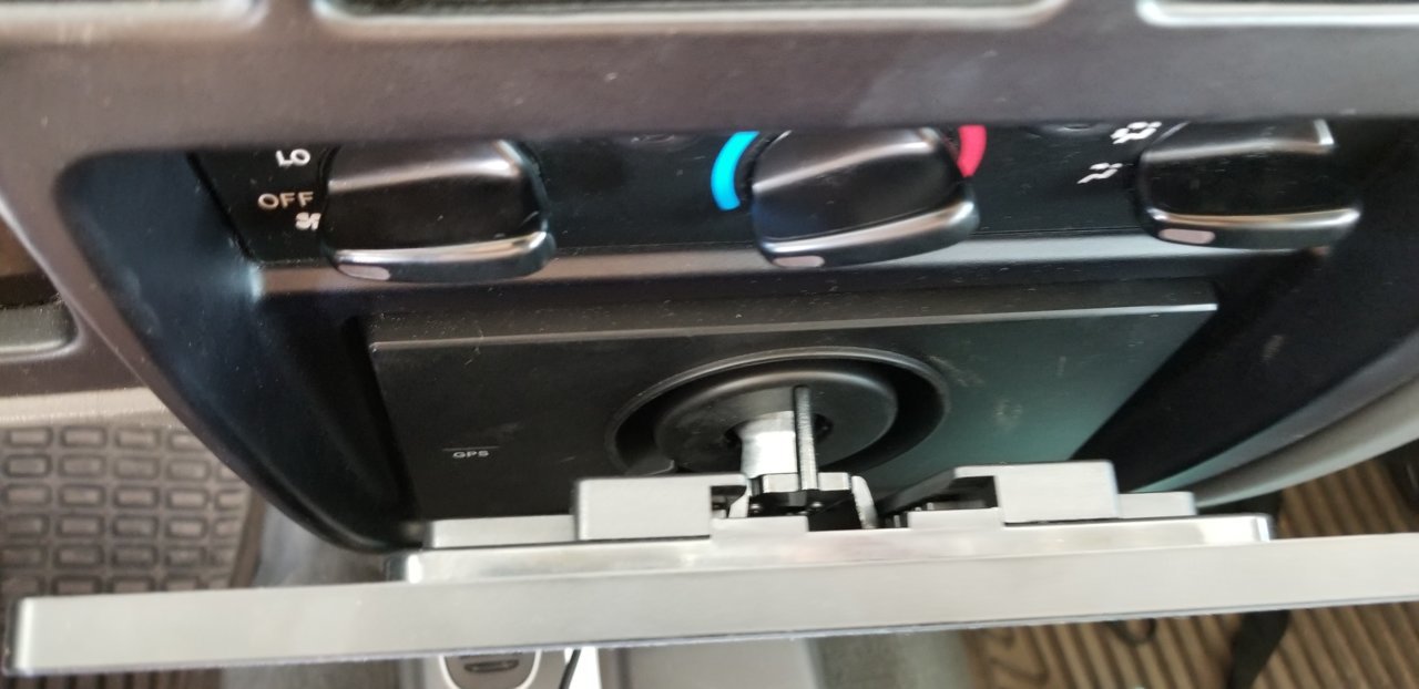

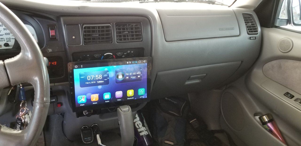

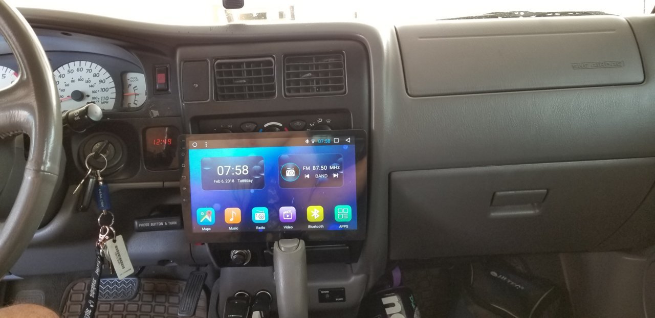

    Sorry for the delay guys, we literally just got back into town. Pics are kind of bright, and my trucks dirty but here ya go. The screen has pull tabs on the back of it that allow you to adjust the height of how it attaches to the deck itself. I set mine to the lowest setting so that I can access the A/C controls, i can still easily get into the ash tray and use the cigarette lighter. The screen moves easily in all directions with two hands, even when gear the selector is in park. I didn't go too crazy in the truck since this is my first time out with it, kind of a shake down for me. I did drive several miles down heavily potted and washed dirt roads, some trails and sand dunes though and the face does vibrate as you would expect (very minimal) but it does not move, the angle of the screen does not change. Build quality is great, it sounds good every single thing works as it should, Bluetooth works great, the cable mic works better than most included mics I have ever had. The touch screen is easy to use and very responsive. Two things I would consider if I were going to buy this deck again. The first is the glare. Luckily the mounting position in my truck is low, i have a camper shell and dark tinted windows. When driving during the day I did have to adjust the screen angle to reduce glare but it was never so bad that I couldnt see the face clearly. If the interior of your car is very bright and your mounting position is higher up you may need to get an anti glare screen protector. The second is that there are no physical buttons or knobs and the volume keys are kind of small (I have been blessed with fat hands though lol) and placed closely together. Trying to adjust the volume while driving means looking down at the small icons on the left hand side of the screen, not easy when your driving in traffic or anywhere where full attention is needed. Overall I am very happy with the deck so far. I messed with the EQ and am happy with the sound that it produces so far, no amps or subs yet. The thing to remember about this unit is that it has a full android OS. So you can download apps and customize this unit completely. If you dont like the EQ settings provided you can download one from the play store. I plugged my GoPro into the USB in and was able to see pictures and videos I had taken on the trip, really cool way to pass the time on the trip home. I have only really streamed music via bluetooth so far, but I am going to try the screen mirroring and USB phone interface soon and I will let you know how it goes. Eonon customer service is badass, I had a question about GPS usage and messaged them on facebook. I got a reply within an hour, not a generic auto response, but a detailed message answering my specific question. This is unheard of with most products, so big ups to their social media team.20180513_124632.jpg 20180513_124753.jpg The boot screen can be customized with a picture or car logo as well.20180513_124706.jpg Tilted all the way down. You can see the micro sd slot here for an optional GPS card. There are several options for GPS, I will be using my phones network connection to run google maps.20180513_124717.jpgScreen angled towards the passenger seat. 20180513_124728.jpg Angled towards the drivers seat.20180513_124814.jpg View from the middle console.20180513_124835.jpg
