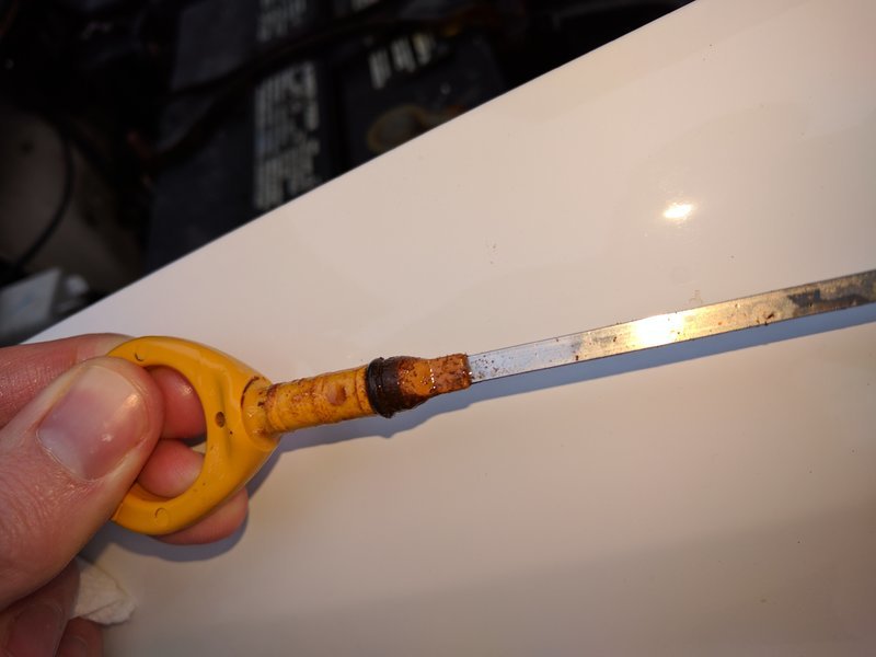

    Been meaning to take care of the same issue for the past 3 months. Oil dipstick completely stuck, allowed for some twisting but I didn't want to twist too much. I used WD40 throughout the afternoon (one application every 15min for 1-2hrs). Rather than use my fingers to pull on the dipstick ring, I used a long screwdriver for leverage and came out in less than a minute.
    Looks like lots of corrosion at the o-ring. Also plenty of corrosion here and there down the length of the dipstick. Going to do some serious cleaning before I put it back in.
    Cheers!

    All cleaned up and now I tried putting the dipstick back in. The o-ring won't fit back into the tube. corrosion inside the tube likely. Thinking about a wire brush or maybe something more heavy duty
