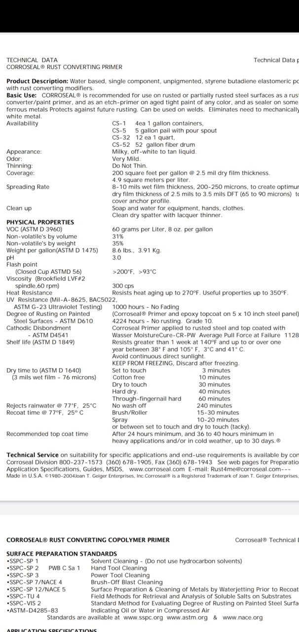

    Attached the spec sheet. Its effective up to 350 F so i sure hope your block isnt getting that hot

    It smoked some at high temp for a few then left a black Magnetite finish which hasn't rusted even though the tractor engine is exposed to weather 24/7

    Thanks for that. Maybe I'll give it more consideration then. I have no idea how hot the engine block is supposed to be. But no it's not overheating.
