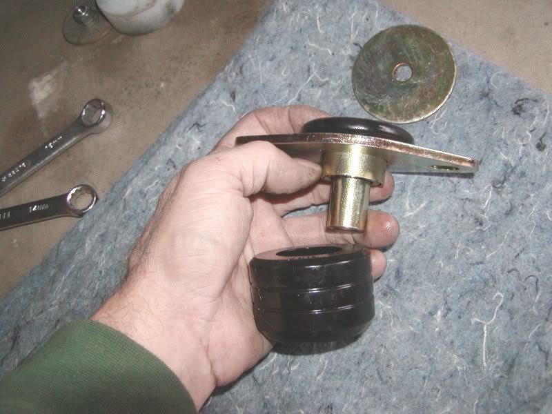

    Hey all, I replaced my factory cab mount bushings this weekend with the kit from Energy Suspension. When it was all said and done, the rear of the cab is 1/2" lower than the bed. We checked and double checked everything and followed the directions, so I am not sure what the deal is. Both back corners of the cab are lower. I called Energy Suspension. They have asked me to take pictures and send them in. I do have a 4crawler 1" body lift, but that shouldn't make any difference. Has anyone else done this and have a similar experience?Thanks.

    I installed the ES body mounts on my '00 extcab
    in combination with a 4crawler 1" BL.
    I do remember the ES mounts were
    a little bit taller profile then the factory mounts.
    Even then... had no issue installing them.
    Mine bolted up without issue.
    Tho' I do know the Dcab mounts
    do not share the same bolt lengths as the extcab.
    So maybe the mounts are not the same either ?
    Possibly you received the extcab mounts instead ?
    Pictures of your install would be helpful...
    as seeing the body mounts could help us in determining
    why yours are not fitting correctly.

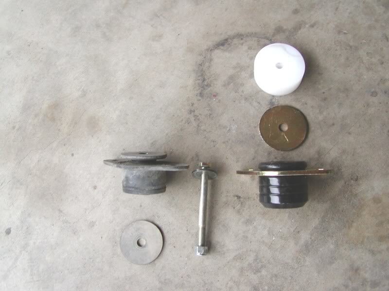

    In both pics, the bushing bushing(s) on the left are the ones under the front cab corners and the one(s) on the right are from the rear cab corners. What concerns me is they are the same height. I didn't take pics of the ES bushings, but the piece that sits on top of the mounting plate from the front were taller than those for the back. I verified the part numbers on ES's website before ordering, and the stated it was the right kit today when I called them. I am supposed to send them pictures also.

    So comparing the pic of your factory rear cab mount bushing to mine, they are definitely different. I will email my pics to ES and see what they say. Based upon my parts and your pics, I am thinking that a dcab should use the same ES bushings on all 4 cab corners.

    my ES BM bushings are for the extcab not your Dcab
    and the ES design could be different now
    bought/installed mine back in '05
    I know there was a difference in bolt lengths for the Dcab
    and I know the Dcab's sub-floor is different at the rear.
    But someone else will need chime in
    to continue discussion regarding the Dcab's differences.
    did the body rest flush on each mount prior to tightening the bolts ?
    Hopefully your phone chatter with ES will net resolve :thumbsup:

    I called my local Toyota dealer and had them compare the mount part numbers For my VIN to those of the VIN of my buddy's extended cab Tacoma of the same year. *Here are the results:
    My double cab--
    Position 2(under front floorboards): *52203-04080
    Position 3(rear cab corners): *52205-04060
    Buddy's extended cab--
    Position 2(under front floorboards): *52205-04060
    Position 3(rear cab corners): *52204040
    Based upon the info aabove, dcabs and xcabs do share the one mount in different positions, but the other bushing is completely different. This will be more than just a couple of washers or shims...it is around a half inch difference. I will wait till I hear back from ES. Their application guide states that the 8.4107G will work for all Tacomas, but that clearly isn't the case.
