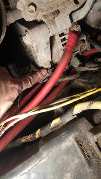

    So I'm in the middle of this fucking big 4 upgrade and need some help. Where the fuck can I ground the alternator from? Specifically where can I bolt onto to get ground on the body of the alternator? Can I use eather of these points? 20170201_202337.jpg 20170201_202346.jpg
    My understanding was that the rear of the alternator body gave ground. But in this article
    http://www.bodenzord.com/archives/477
    This guy references to alternator ground at mounting bolt.
    Anyone care to shed some light? I gotta get this shit done tonight.... Gotta work tomorrow.

    You don't need to ground the alternator, as the ground goes to the bolt above the oil pan.

    I realized this from the original post. I have everything o this list already down and bolted. My issue is I want to ground the alternator directly to frame. There's alot of well informed electrical engineers that will speak on the benefits of directly grounding your alternator.

    I don't know many engineers, but I do know that the alternator is grounded directly to the block since it is bolted to it; so why bother with an extra superfluous wire?

    The larger second bolt you pictured, make sure it's got continuity with the ground, make sure to clean contact points before hooking up, then run it straight to the battery ground. This is a general guess but I think 4 guage wire would be enough.

    That was my guess as well. Thank you. I just didn't want any fuck ups in the electrical system. Don't need any fires in this fucker

    No.... You posted before I answered. Now that I have, I'll look into jumping a short black wire from the alternator casing to the block ground bolt.
    I have a 130 amp alternator.
