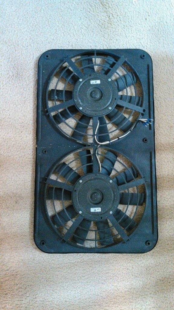

  13. Aug 23, 2023 at 4:37 AM
    MA_TACO
    MA_TACO Well-Known Member
    Jan 28, 2018
    #242689
    667
    Wesley Chapel, FL
    Bringing this back from the dead to share my experience. Mods are in my sig but recently I went offroading in 100+ degree weather and slow crawling through the woods with AC on. AC stopped blowing cold and engine temps reached 225deg before I decided to turn the ac off. Engine cooled back down to 195-200. Had to put it in neutral a few times and rev the engine to get the clutch fan spinning to cool it down. On the highway it'll run normal 186deg with ac on. This is with the factory clutch fan. I switched to a dual Spal 13" fan setup with Derale fan controller and also added a Mishimoto 10" fan in front of the condenser wired to come on when ac clutch engages. The total opposite is happening now with electric fans. At stop and go, offroading etc in 100+ deg heat the temps stay in the 190-200 range with cold AC and highway it'll creep up to 200-208 doing 70mph still cold AC. I do feel a little extra kick when accelerating after electric fan conversion. For anyone thinking about doing this conversion it is pricey. Sitting at idle with all fans kicked on the voltage is 12.5-13.0. No bueno. The factory 130 amp (tow package)Alternator needs to be upgraded along with wires. I'm going with a 250 amp from JS Alternators and the Tacoma "Big 7" wire kit. Waiting for those to show up but I'll say I'm pretty happy with my setup for what I do with the truck. I'll also say that if you use your truck as a grocery getter and don't mind warm ac in hot ambient temps sitting in traffic then stick with the clutch fan.
    20230823_073243.jpg 20230823_073150.jpg 20230823_073225.jpg 20230823_073044.jpg
