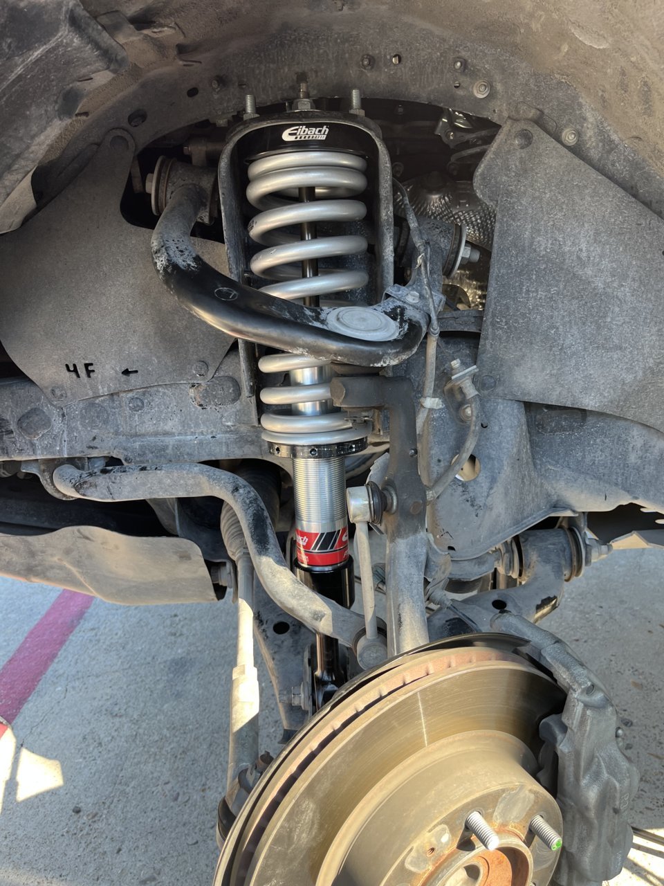

    Hi y’all! I just installed the Eibach Pro Truck Stage 2R suspension on my 22 SR5. The rear shocks feel great, but the front coil overs are very bouncy. As soon as I pulled out of a parking spot it was bouncing. When I went over pot holes or speed bumps, it felt like the truck was going to disassemble. I did max out the height though, and after calling eibach they said I should lower the ride height, and then get an alignment. Any experiences with height and ride quality.

    I would also loosen, and then re-tighten all suspension parts with bushings while the truck is at its new ride height.

    Looks way too cranked up / tight. Definitely lower that and see what it does. Seems like it would be way past being able to droop / beyond max lift and just heavily preloaded like that.
    Also you do need to loosen and only tighten your control arms with the weight of the truck on them...these bushings simply flex and not rotate, so clocking them in a full-droop position will simply tear them up quickly, and may worsen that bounce feeling since they would be under a lot of tension.

    You know the max is 3.9 inches there is a picture online. This is wayyyy too high!

    those are way too high, and probably the reason yours bounces like it does. in the instructions there is a measurement of how far you can adjust these based on the amount of threaded area below the collar. youve gone way past the max adjustment. I have the stage 2/2r set to what it was out of the box, and I love the way it rides

    this guy is like double that with probably no down travel left, asking why his ride is trash

    Over extended and topping out as noted above. Did you take a before and after measurement to see the amount of lift added?
