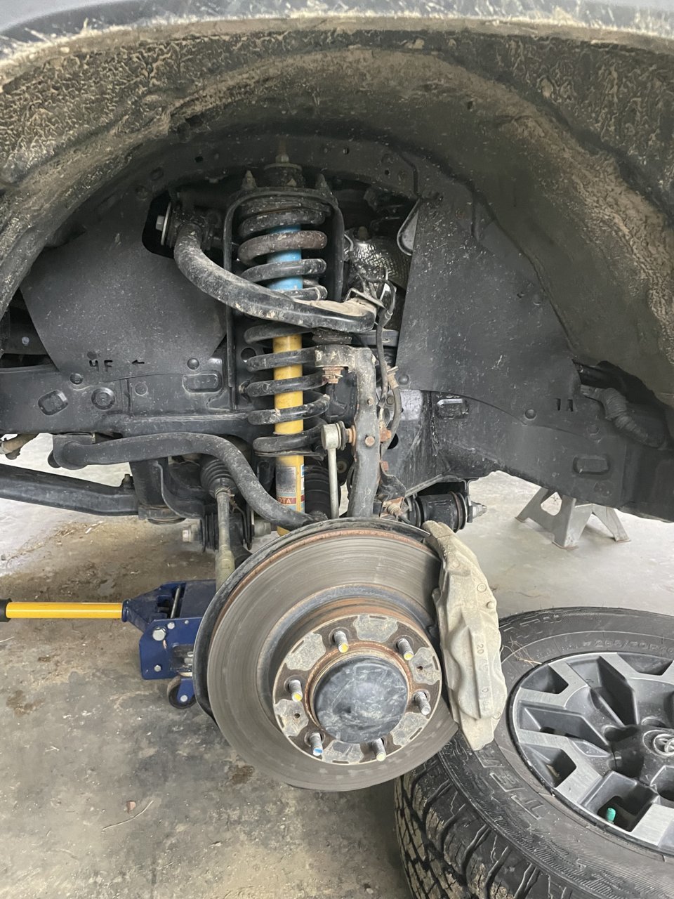

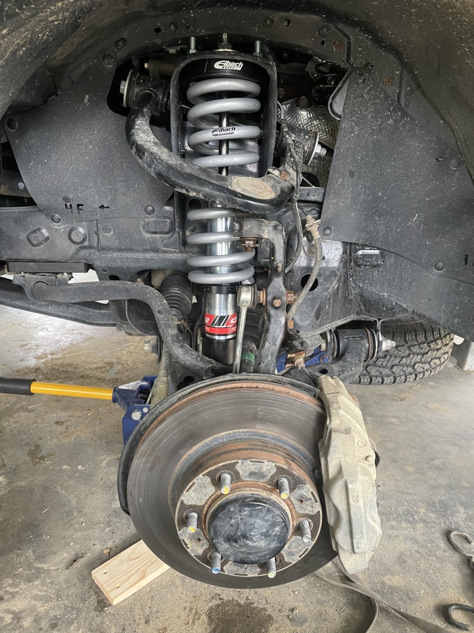

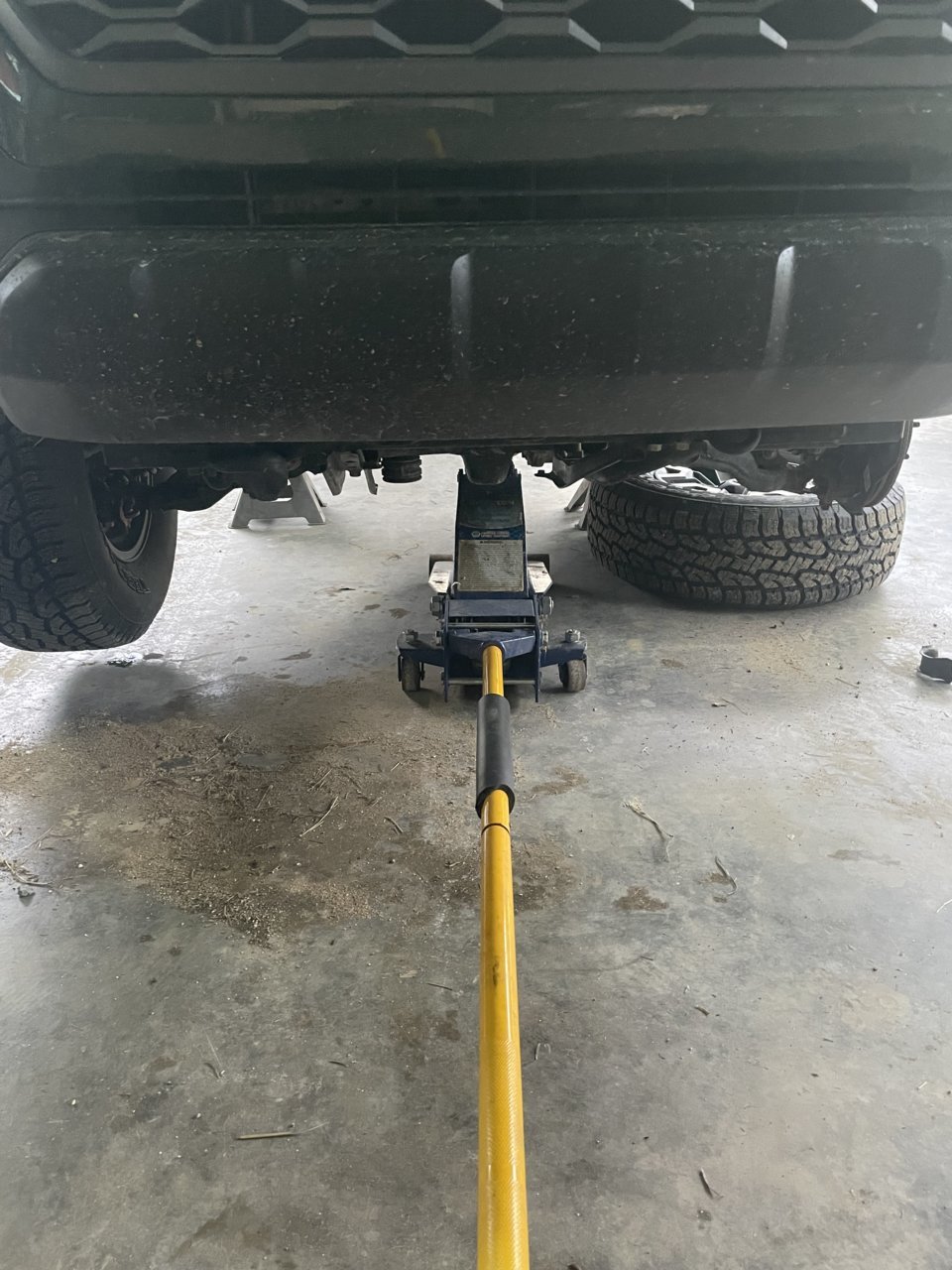

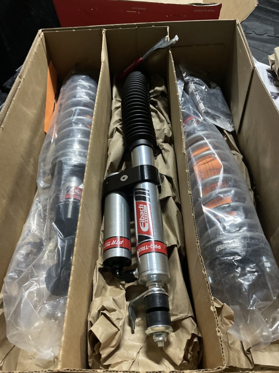

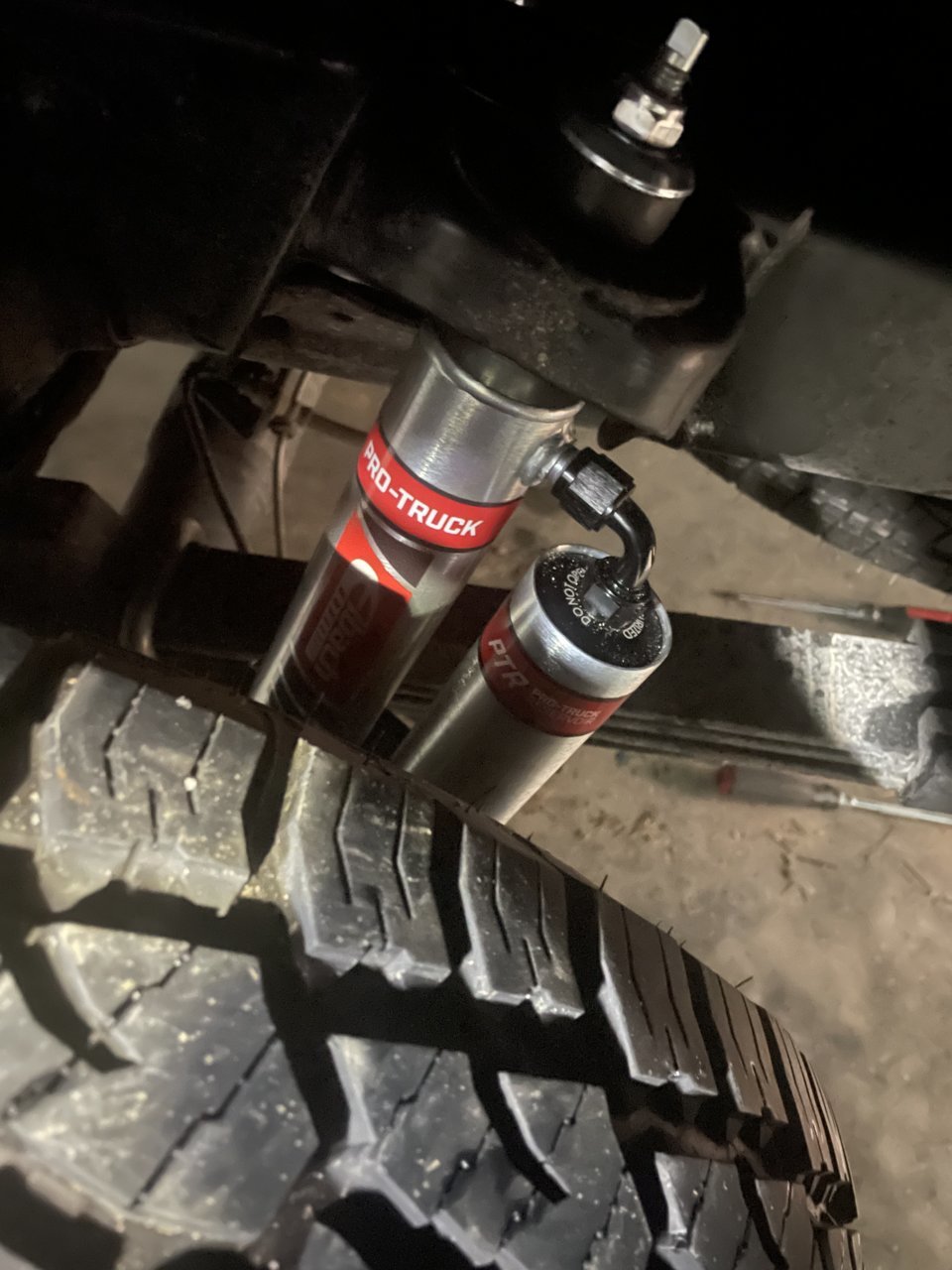

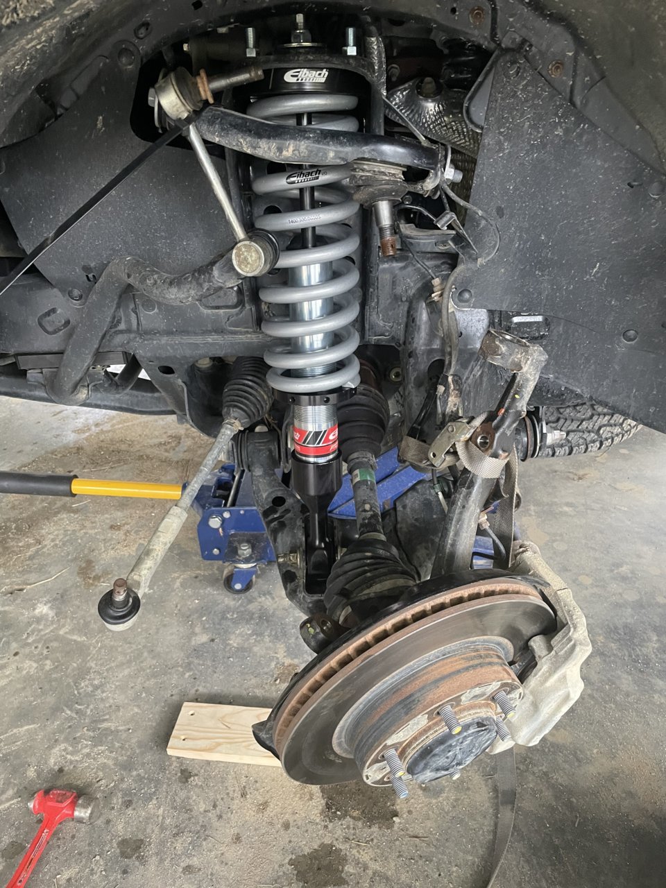

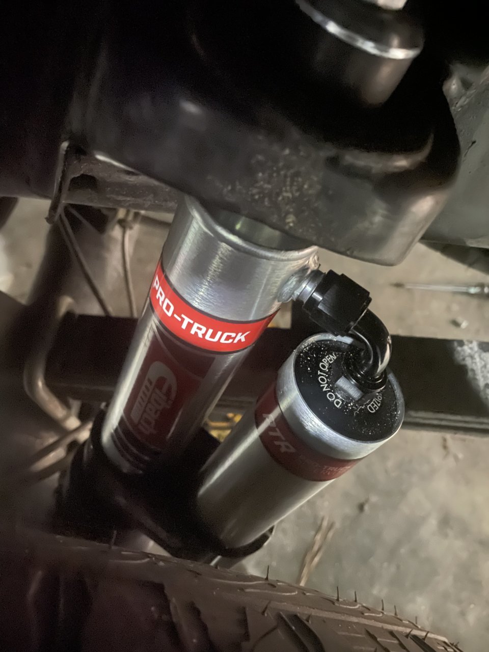

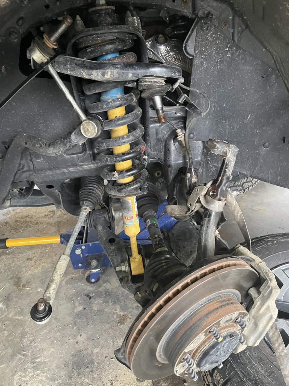

    Eibach Stage 2r
    PRO-TRUCK COILOVER STAGE 2R (Front Coilovers + Rear Reservoir Shocks )TOYOTA Tacoma SR / SR5 / TRD Sport / TRD Off-Road
    E86-82-007-02-22
    F46FC5E2-097C-4662-A765-71EB78FD38C9.jpg CD161076-E634-4AA8-8240-F1BD383323E5.jpg 0B5AACB6-63F8-4DCF-B52F-9BB7A14596B8.jpg A7F65A9B-AA27-481A-AA8B-1176492C5B09.jpg 978EAF29-67C7-4382-A4BF-44B13753B737.jpg 27C870B7-D55B-4C86-A3E5-1CFB7DF3C29A.jpg BCAD0D4A-19AC-4315-8F90-734B897BC2FE.jpg B32C83B6-43E3-4017-B2ED-4791298A1C96.jpg 08763643-7F7D-4AF4-818A-CA06C393007E.jpg 63FF1BEE-7A78-4B0D-87A9-DDB2C8213D31.jpg BA55C50D-8AA3-48FA-A5C5-5567BC1A34CA.jpg 63A4552E-5D10-4E63-A310-8B4C4A7A1F94.jpg 0DDCA676-23DB-4D66-B455-250CEA301766.jpg
    before
    DF 34 1/4 from ground
    DF 20 1/2 from center of wheel cap
    PF 34 1/2 from ground
    PF 21 7/8 from center of wheel cap
    already had rear shocks installed No before rear measurement. No block or add a leaf’s yet
    DR 35 15/16 from ground
    DR 21 5/8 from center wheel cap
    PR 36 from ground
    PR 21 7/8 from center cap
    After from coil overs installed
    DF 36 3/4 from ground
    DF 22 3/4 from center of wheel cap
    PF 37 1/4 from ground
    PF 23 from center of wheel cap
    DR 36 from ground
    PR 36 1/4 from ground

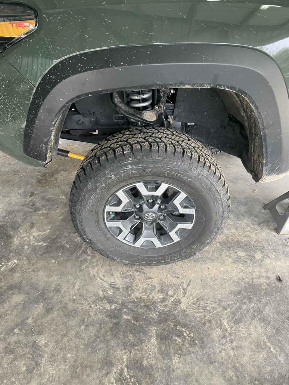

    Got about 50 miles of driving on it. To me it feels better more like a truck. My nephew said the truck rides better. I went with stage 2 r. I drive on sand bar and live down a gravel road that is poorly maintained. I also drive on a lot of unimproved roads where I live so far so good. But only 50 miles. I will most likely be adding headstrong off-road add a leaf if not I’ll just go with Eibach spacer. I only tow a small aluminum boat. Mickey Thompson Baja boss in 265 or 285 70 17 And AGP rock trail or TRD pro replicas.
    Picture of where I spend a lot of my time.

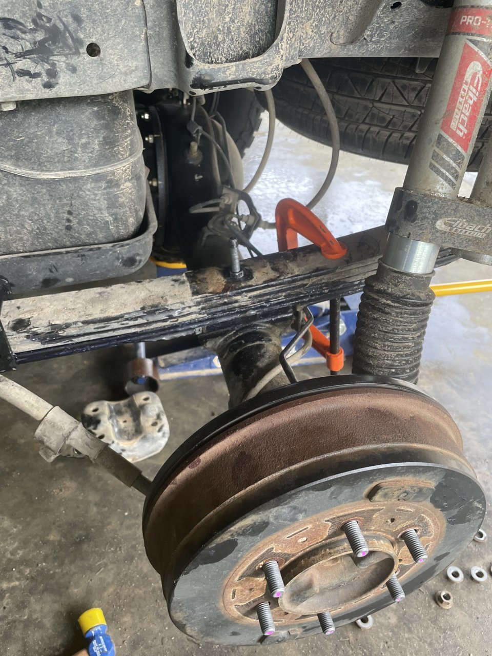

    Head strong add a leaf.
    67D088B6-80AB-4514-928B-65F5AC7B3B25.jpg 0C861896-CB1C-402A-BF8D-71542A453D3C.jpg 6410B267-E659-4848-B6AA-DFC1DDE415FE.jpg 196D93A1-E25F-41B8-9A0D-D0399101664B.jpg 959F0D92-479C-4E4B-8F3C-A2A0BFEFE70E.jpg C29CA195-DA85-4FCF-B049-71D8CCDAAD7F.jpg B5344DDA-0356-45A7-B87C-A8EB05863B0E.jpg
