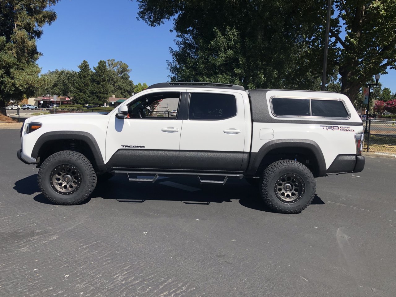

  9. Aug 13, 2022 at 6:20 PM

    Just had my Eibach stage 1 (first clip) with 3 leaf add a leaf installed this week. I had my 265/75/16 Good Year ultra terrains installed today. Really like it so far! It looks low in the rear due to the parking lot!
