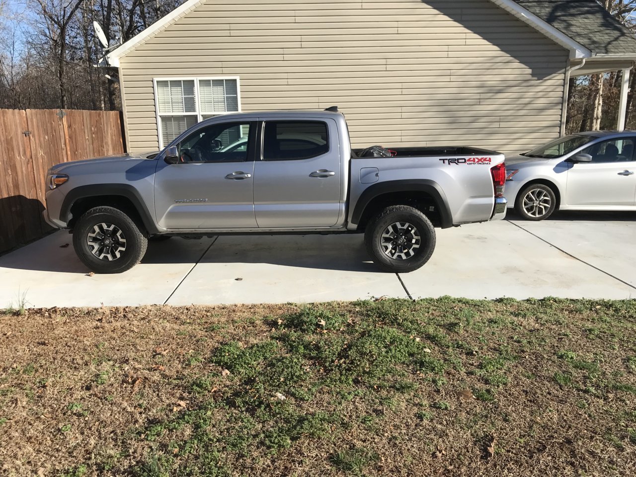

    I did the OME 885 with 5100s front and rear and the wheelers progressive AAL to keep the factory rack with 2 inches front and rear. I also did the ECGS bushing as a preventive measure since the front end was apart. All in with parts were just under $800.
    You can put it all together for that price except for the bushing and add a driver side lean spacer at headstrong offroad.
