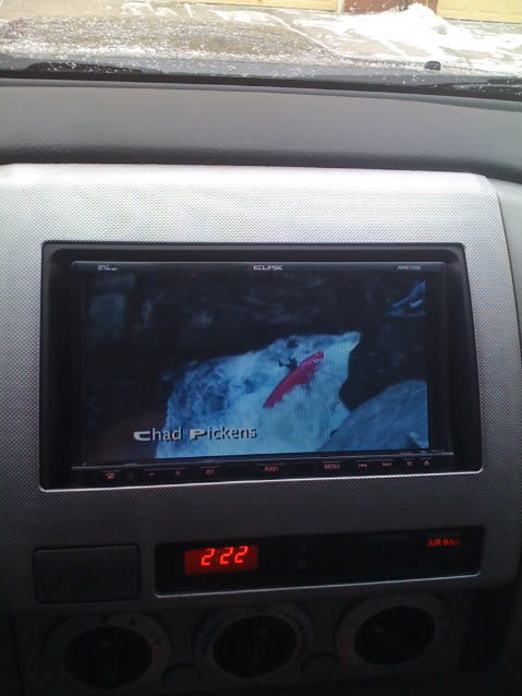

    Ok I updated my iPod touch 2g to IoS 4.1 and it stopped working on my avn726e...anyone have this issue yet? Is there a fix?

    I dig the crash and burn off Gorilla! One of my favorite drops for sure.
