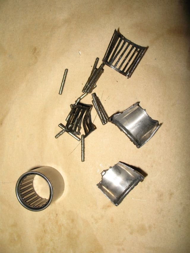

    No need if there's no issue. I changed out for the bushing on a 2017 with 1086 miles on the clock. When I pulled the bearing, there was a needle already missing from it. You can see in the pic the top needle. Thankfully I found it just on the inside of the seal, it was broken in half.
