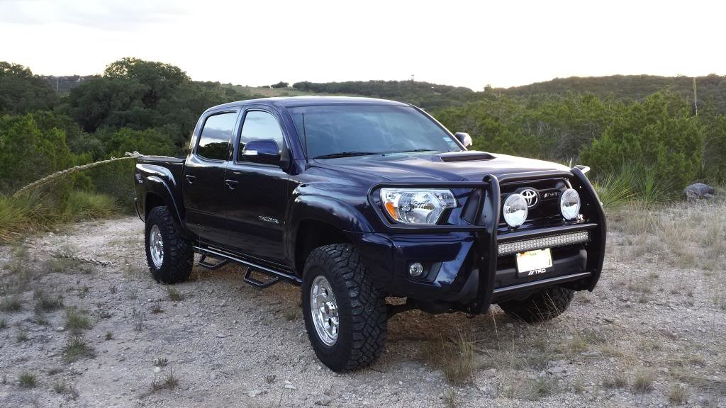

    I originally bought a Rigid 10" SR Combo (spot/Flood). I was not that impressed with it. My 35W HID headlights washed it out, you could barely tell it was on. I did some testing without the headlights on..where I blacked out the spot or flood LEDS with electrical tape. When I blacked out the flood, you could not even tell the difference. When I blacked out the spot lights, the flood lights were about as bright as my DRLs(I am not joking). I removed it and never even used it. I am sure a 30" or 50" produces a light more light, but I am not going to spend over $1000 for offroad lights. I try to buy American, but MY wallet comes first.
    I did some research lately and I discovered just about everyone of these imitation Rigid Lights you see on Ebay with no brand, or some popular vendors (OKLED) on TW, or "Cree" or another brand like Hanma....is made by Totron. I found 30" SR SPOT light bar on ebay from http://stores.ebay.com/eg-motor?_rdc=1 for $180(free shipping that came in 3 days from china! & this store had a 99.6% rating)...I got it and I was really impressed. I doesn't throw as far as my Hella 700 HIDs, but it fills in everything very nice. And by itself, this Spot LED is more like a "Eurobean" or narrow flood light. Says it is rated at 9000 lumens.
    I was so happy with my Totron 90W single row, I just had to see how bright the double row is since it is suppose to be twice the lumens...and sure enough...it is twice as bright and fit perfectly under my grill guard. It is brighter and throws just as far as my 55W HID Hella 700s
    It is the 32" 180W CREE SPOT (only)..I got it for $300, vs the $1200 for the comparable Rigid. Got it from the same ebay store. http://stores.ebay.com/egmotor/ that has a 99.6% approval rating. Says it is rated at 18,000 lumens
    These LED lighst are real popular with the Razr & Can-Am ATV crowd...and many of their forums say They can see no difference in the beam/brightness from a Rigid to a Totron bar. They say the construction is virtually identical. Rigid claims they have better heat dissipation, but what does that matter when you are driving?
    I have notice the Spot on these LED bars come in either 8 Degrees or 30 Degrees. I have the 8 Degree bar.
    If I were you...go with the Spot or Combo.
    If you end up buying a Totron bar off ebay, be careful. The first Gen do not have Cree Bulbs in them and are much cheaper, but look the same...be sure you are purchasing the second Gen with the "Cree" bulbs. There are some new 10W CREE bulb coming out, but those bars are slightly larger. So for every size light there is a much cheaper one that has the Epistar bulbs. I also read in my research...the 1st gen Totron light bars...the paint came off and exposed a copper color metal. They say the issue has been corrected on the newer versions.
    To sum up..yes go for the ebay/Totron LED light bar.
    35 HID headlights only
    Headlights & 32" Totron LED (Spot)
