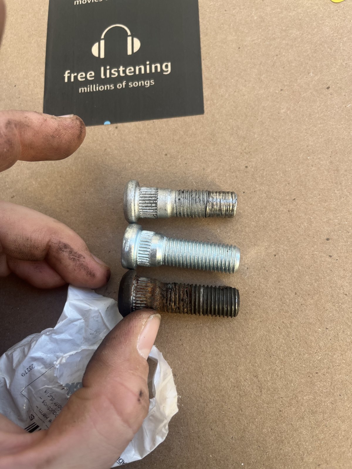

    Hey man you got any more info on those studs you ordered? I got a pair of hub assemblies from Yotabearingsandhubs and my mechanic immediately decides to fuck one of the studs and over-torque the rest. I had a fun time finding out that they used smaller diameter knurl (12.9mm) instead of oem 14.1mm knurl studs.
    In the photo attached, you can see the three side by side.
    The top clearly is the stripped one that came in my new hub assembly. (12.9mm knurl)
    Middle is a new Dorman stud I got from Autozone. (14.1mm)
    The bottom is the OEM stud I removed from my old hub, thought I was home free to just replace them all with OEM... wrong (14.1mm)
    Working with the guy Dave from Yotabearingsandhubs to get new studs sent out and find a spot to order more, but this seems like a disclaimer should be on the website. These are different spec studs. If I was out on the road and had an issue, I would have been pretty fucked.
