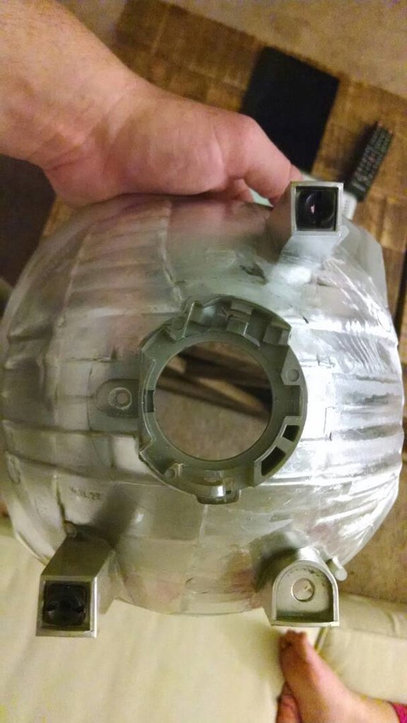

    I know most people that have done the BHLM or retrofitted know this little trick, but for those who haven't yet, it's a life saver.
    The chrome on the inside of your headlights is a bitch to get off. Between the curves and crevices and angles it's hard to get a sanding cloth in there to remove all the chrome layer. Acetone will work, brake fluid will work, and so will paint stripper. But these methods require lots of scrubbing and patience, or you may end up melting the plastic too. Bleach takes the chrome off, and leaves the plastic alone.

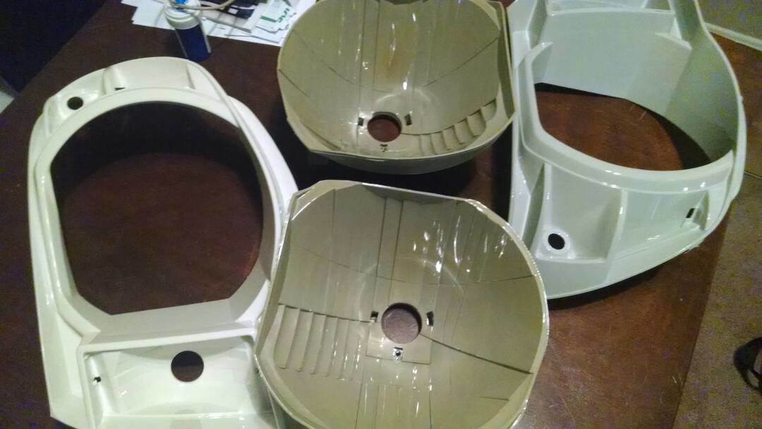

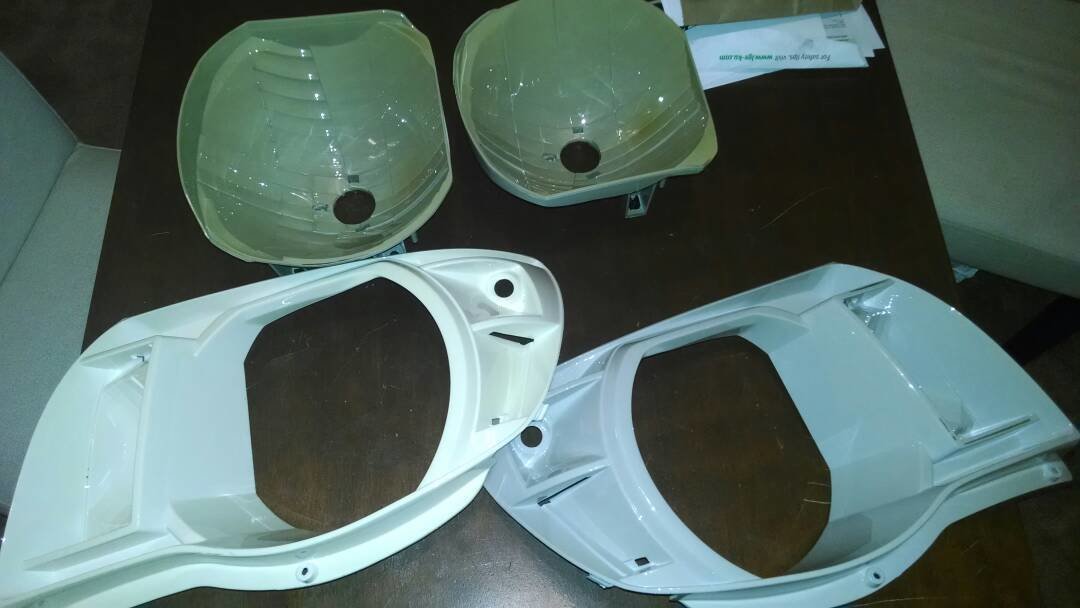

    Put in your chromed pieces and leave them until the chrome is completely stripped off. The first 2 reflector bowls and bezel were done within an hour. The last bezel took a whole day to strip off. It may have been that the chrome on that piece was adhered better, or that the bleach lost its effectiveness after de-chromeing the other pieces. Regardless, here's what it looks like after
