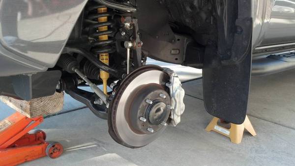

    My first post (well technically my second counting my intro), so I wanted to show some pics of 2 weekends ago when my cousin and I lifted my 2012 Taco.

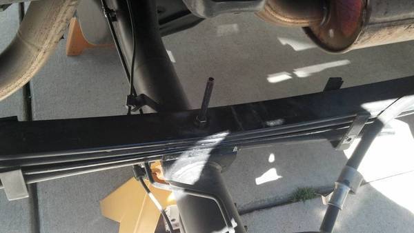

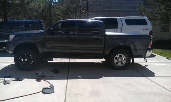

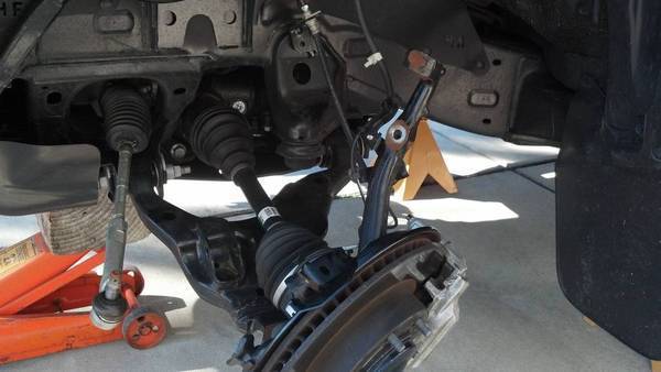

    First some info, this lift is the 3" Procomp kit that includes new coils, shocks, and an add a leaf. I was somewhat concerned about using spacers in the front and only blocks in the back, so we went with this kit and I am pretty satisfied with the results. The Procomp part number for this kit is #K5075B. I could not find this kit on 4WP or Procomp's site, so I wanted to list it here for those interested. The kit seems to be very well constructed and after installation and a front end alignment, it drives exactly as it did when I droe it off the lot. The ride itself is noticeably stiffer (due to the additional leaf in the rear), but this was expected. Even with a little stiffer ride, it drives just fine on the highway and doesn't beat you to death when hitting potholes, etc. Overall I am very satisfied with the lift.

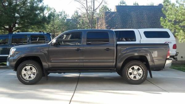

    The before shot ...

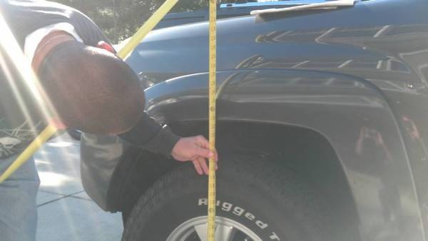

    Always take measurements ...
    Factory wheels off ....
    IFS broken down ...

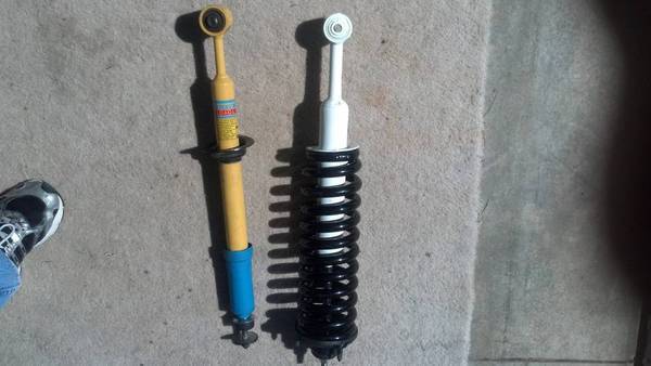

    Small difference in the factory suspension :) ...

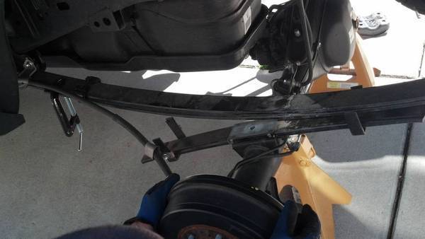

    The rear undone ...
    Leaf added and back together ... and yes, we cut the bolt ....
    Final product with lift and new wheels and tires ...

    What size tires and rims. It looks great...

    Sorry, I forgot to mention that in my original post.
    18x9 XD Monsters and 305/60/18 Procomp Xtreme's

    They did not come pre-loaded. We had to compress and use the factory top plate. No new UCA at the moment, factory UCA still in place, but I have not had a chance to get off the highway and abuse it to see if it's needed.

    What's your centre of hub to underside of fender measurements ?

    I did not do any self measurements, but the exact wheel that was purchased had a backspace of 4.53" / -12mm. This was what was recommended by 4WP and also confirmed by tirerack.com.

    No , your lift measurements , what is it from the centre hub of the wheel to the underside of the fender

    Oh, lol, sorry. I had them written down, but it's on paper at my cousins house. IIRC, I ended up with right at 3 1/2" of lift on both sides in the front and 3 1/4" in the rear on both sides. This was done measuring from the ground to the bottom of the fender, not from the center hub. I'm told this will settle to about 3", but time will tell.
