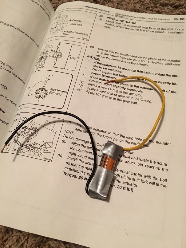

    I picked up an e-locker axle to put into my sr5 Tacoma. There's a ton of info out there on the subject, but it took me awhile to get my head around the actuator install so I thought I'd add some pics to help the next guy/gal out. I'm sure it was explained in one of the dozen locker swap threads I've read, but it went over my head

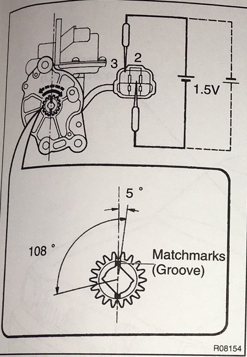

    Essentially three things need to match when installing the actuator: The locking fork in the differential, the dash switch, and the actuator gear. They either need to all be "locked" or "unlocked." I didn't understand that the actuator gear mattered that much, I thought it would just get turned either way by the switch, and either lock or unlock the diff, but that's not true.
    Once I figured out what the FSM was trying to get you to do it helped understand it a lot. Basically, the FSM instructions assume the motor/actuator state is unknown, meaning it could be locked, unlocked, or somewhere in between. So what it gets you to do is line up the drive gear of the actuator to be in the "locked" position. Then you put the actual locker fork inside the 3rd member into the locked position. Then you reinstall it with your truck switch also in the locked position so that everything is matched.
    This is less important if you are taking the motor out of your own truck for a differential rebuild or something, because then you can just put it back the way you took it out. (i.e. leave the motor and your dash switch unchanged, and just flip the fork inside the differential to match once you re-install). The third member will only install into the axle housing if it's locked, so if you took the actuator off while unlocked you'd need to push the toothed rail on the locking fork outward, toward your driver's rear wheel, to unlock it. The manual actually tells you to turn the truck on and lock the rear diff before starting the job, which would eliminate that step.
    But if you don't know, or if you're putting in a new actuator, you need to go through the alignment process to get it to the "locked" position.
    In my case I got the axle, housing, 3rd member, etc. all disassembled. I also knew the guy I bought it from had bench tested the actuator to make sure it worked so I wasn't sure where the actuator was at when I got it. This is important because the drive gear won't just spin infinitely in either direction. It actually has a very short travel range. Where the FSM page says "if the matchmarks come to the extension limit of the rotation, don't electrify moreover" I was thinking WTF? "don't electrify moreover?"
    I found this out the hard way, but that means "stop" because if it hits the end of its rotational limit it will bind.
    a 9 volt is handy (more on this later) but a AA battery (1.5v as the manual indicates) is better because it moves the gear slower, letting you fine-tune the position easier.

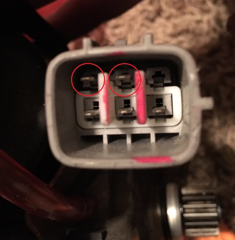

    You just use direct contact with the two pins circled below. alternating which pin has positive will determine which way the gear turns.
    When you're using a battery to move the gear to get it to the right spot, if you go the wrong way and hit the end of it's travel, STOP immediately. Or else it gets stuck. I went searching both ways (clockwise and counter clockwise) and hit the end of the travel on both sides. This is where the 9v can help. Alternate the pos/neg wires, but with a 9v battery instead of the AA, and the extra oomph seems to help get the gear back moving the opposite direction. I thought I seized the actuator several times by hitting the limit, but repeatedly hitting the pins with 9v got it unstuck. I was able to get it unstuck with the AA once, but it took awhile.

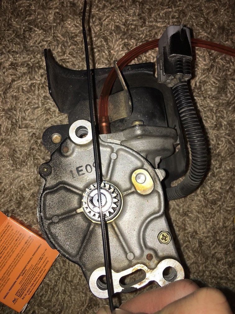

    First hold the actuator in it's mounted orientation as though it were on the truck, looking at the gear side, so the breather tube is straight up. If you draw an imaginary line from the right hand side of the lower stud hole to the right hand side of the upper stud hole flange, it goes right through the center of the gear (upper half of this picture in the manual):

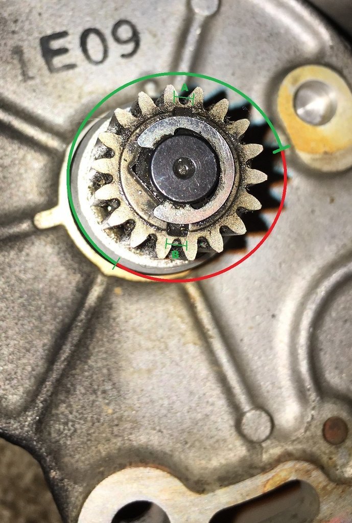

    The matchmarks are wide grooves, but can be partially covered by the circlip that is holding the gear on. As I found out by hitting the rotational limit on both sides, the gear has a short travel. If you look at the picture below I've got the top matchmark where you eventually want it to be. Using that top matchmark as a reference, its range of travel is approximately the green portion of the circle.
    So as you can see, matchmark "A" is the only one that can ever possibly be at top dead center. This helped me understand their directions a little better, because just looking at the manual at first it didn't make sense which mark needed to be aligned up top. Basically the only one that can.

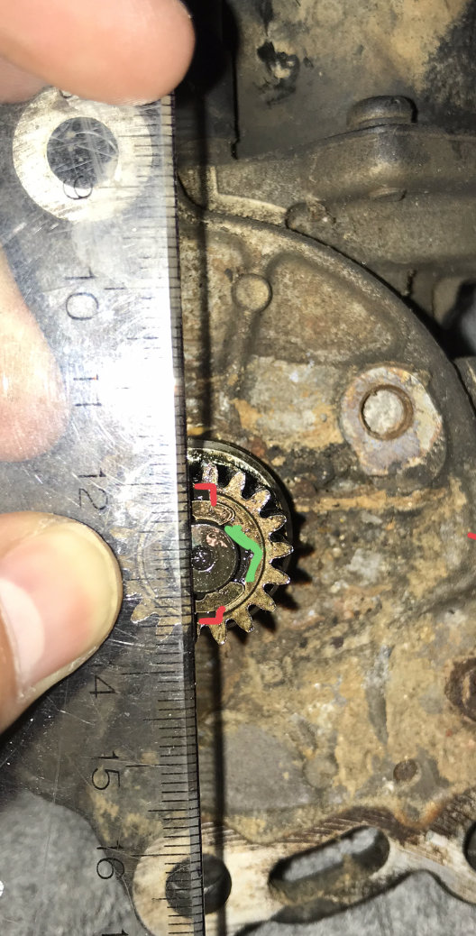

    You want it to be close to vertical, and are shooting for 0-5 degrees offset to the right, or clockwise, but note that the matchmarks themselves are almost a whole tooth wide. Which is about 21 degrees. So you don't even want the whole mark to be past the vertical line (which would put the center of it about 10 degrees off vertical). You want it about where it is in this picture where you can still see some of the lower mark sticking out past vertical on the bottom. In fact, if the two marks are equally positioned on your imaginary vertical line then you're at 0 degrees and probably good to go:
    When you're using the battery to line it up it's actually a lot easier to check its location with a string or something you can pull tight, as seen here, but it's harder to do that and take a picture at the same time
    The last part of the alignment is done while mounting. The slot between the two bottom mounting holes aligns onto a pin on the 3rd member, and the pin should be in the far left side of the slot when looking from the outside (the far right side in the picture directly above). With the matchmark where it is in the picture, I was able to line the actuator up with its mounting holes, just jiggle it a little to mesh with the locking fork gears, and it slid right in with the pin in the right location in the slot. Hope that made sense to someone!

    you happen to remember which pin you have to hit with the positive to make it turn counter clockwise, and vice versa?
    mine will not move, even with the 9v, and i need to get it to turn counter clockwise, but don't know which pin i need to hit to make it do that.
    i've spent about 20 mins trying both and neither makes the motor turn at all.
    maybe this thing is just ceased? i did buy it from a dismantling company online, but, they say they test and garuantee their parts

    No, that "green" section is just the opening for the e-clip. It doesnt matter where that's at as long as the match marks are correct.

    I'm going through this now...Appears an earlier poster stated it needs to be installed in the locked state. when the gear is facing you which direction is fully locked? does it turn counter clockwise to be fully locked or is it locked when the gear moves clockwise? thanks!
  16. Jan 5, 2023 at 12:02 AM
    #16
    6 gearT444E
    6 gearT444E Certified Electron Pusher
    Feb 3, 2018
    #243372
    7,770
    Deep South
    Herculiner Hootus
    looking at the face of the gear it will turn CW to lock
  17. Aug 19, 2023 at 9:01 AM
    #17
    NudeLobster
    NudeLobster Well-Known Member
    Jan 18, 2017
    #207914
    346
    Justin
    Tucson, AZ
    2006 Lexus GX470
    The direction/polarity is shown in the FSM picture. Negative goes to pin 3(farther from the blank pin) and positive goes to pin 2(middle of the row, next to blank pin) to turn the gear CCW.
    also if you’re overtraveled and 9v won’t get it off the limit, give it a quick second of 12v jumped straight from your trucks battery. that turned the gear off the limit instantly.
