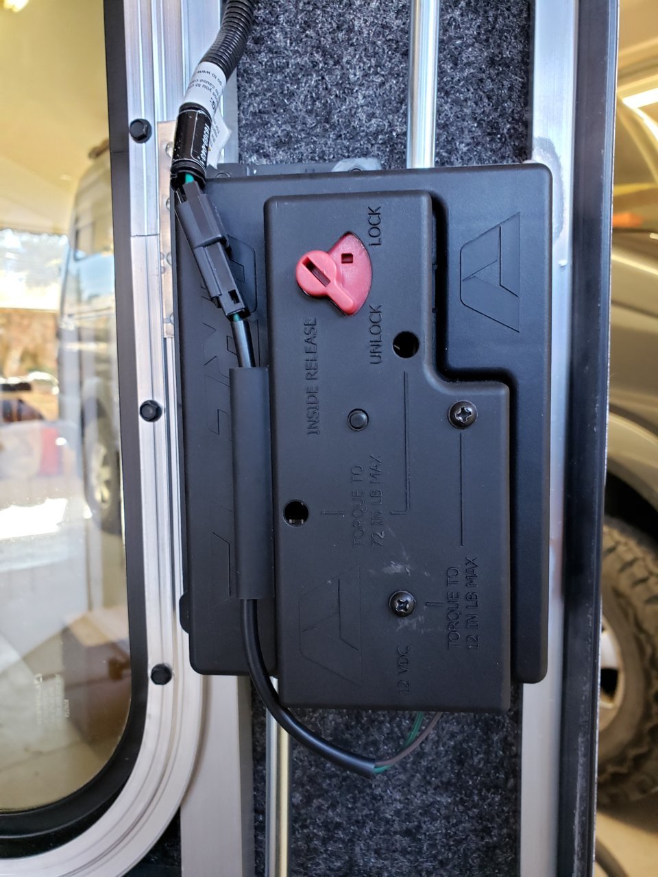

    I just put a brand new A.R.E. topper on my first gen Tacoma, the topper came with an electric door lock which should work with pickup door locks. The installer did not have a wire diagram for my older Tacoma so sent me home with out the lock working.
    Does anyone know how to wire this thing so it works?

    Post pix of the mechanism and wiring harness. Name of lock manufacturer would be helpful also.

    Hello Black DOG Lila,
