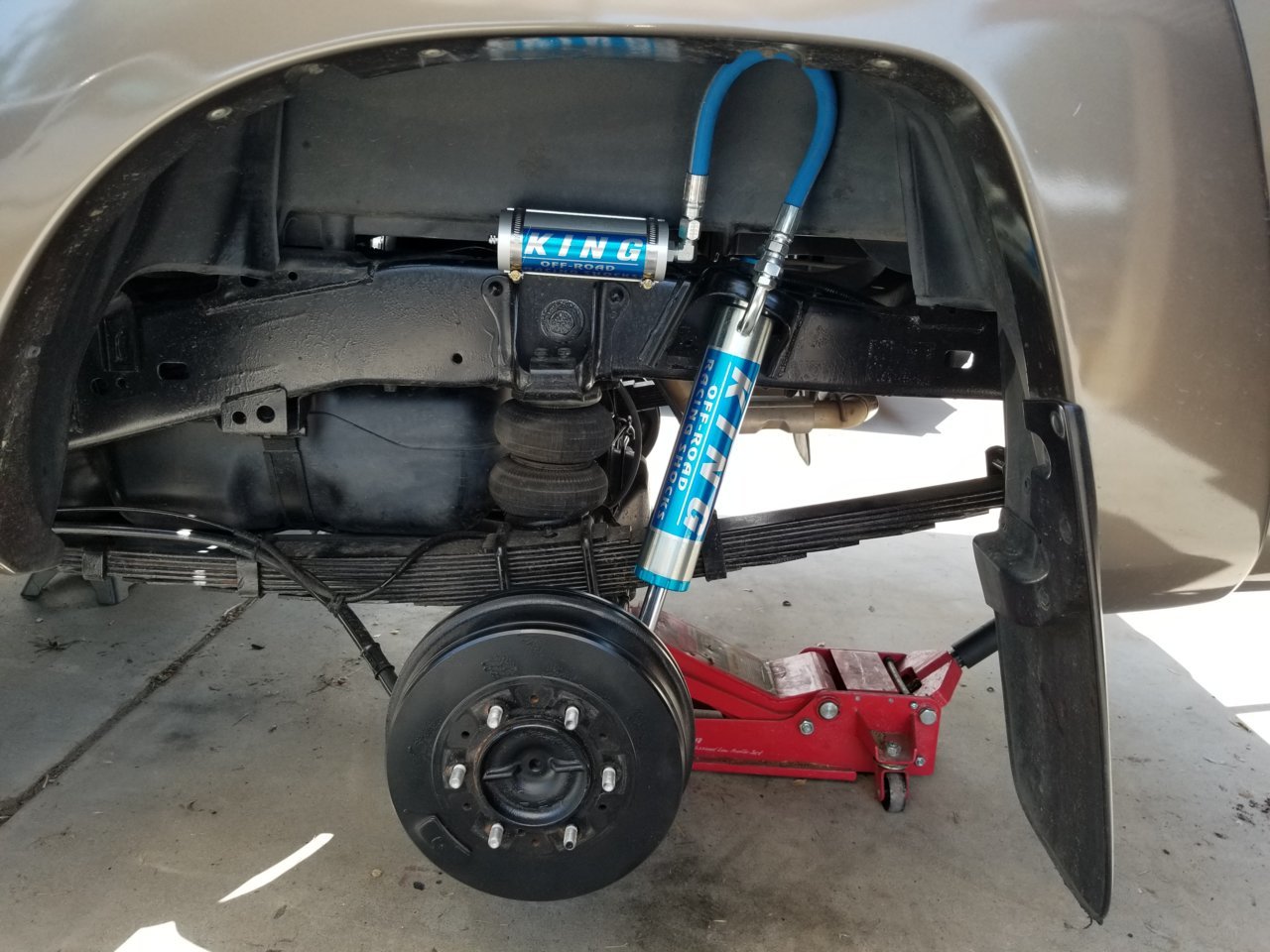

    Been through many a thread looking to see if what others have done with their parking brake lines, but haven't come across anything. With the Icon stage 4 kit AAL I lose the leaf keeper with the bolt that holds the line guide. Without it, I don't think it's really going anywhere, but I haven't found a good way to keep it attached. For the time being I have thrown a zip tie around it, but looking for a more permanent solution.

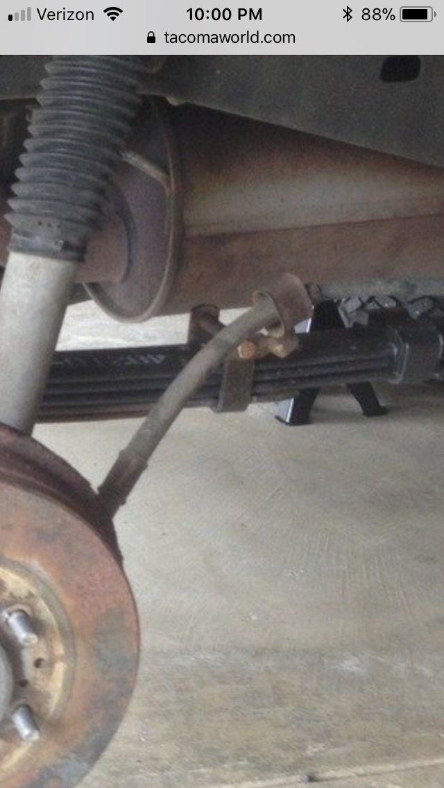

    remember seeing a picture somewhere on here were they just put it on the same bolt as those clamps that hold the springs aligned.

    not Mine but found a picture. Don’t know if this helps.

    Thanks for the pic, unfortunately on mine that keeper is too far forward and bolting the guide to it would pull on the brake line.

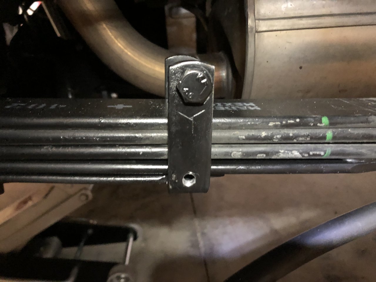

    I’m going to drill and tap the lower part of the spring keeper like the ones on the overloads were. I’ll let you know how it goes.

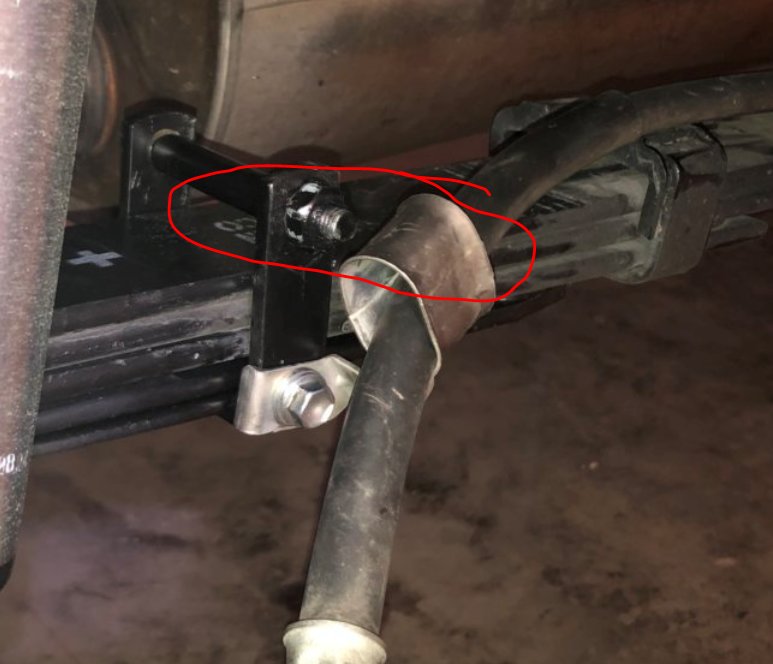

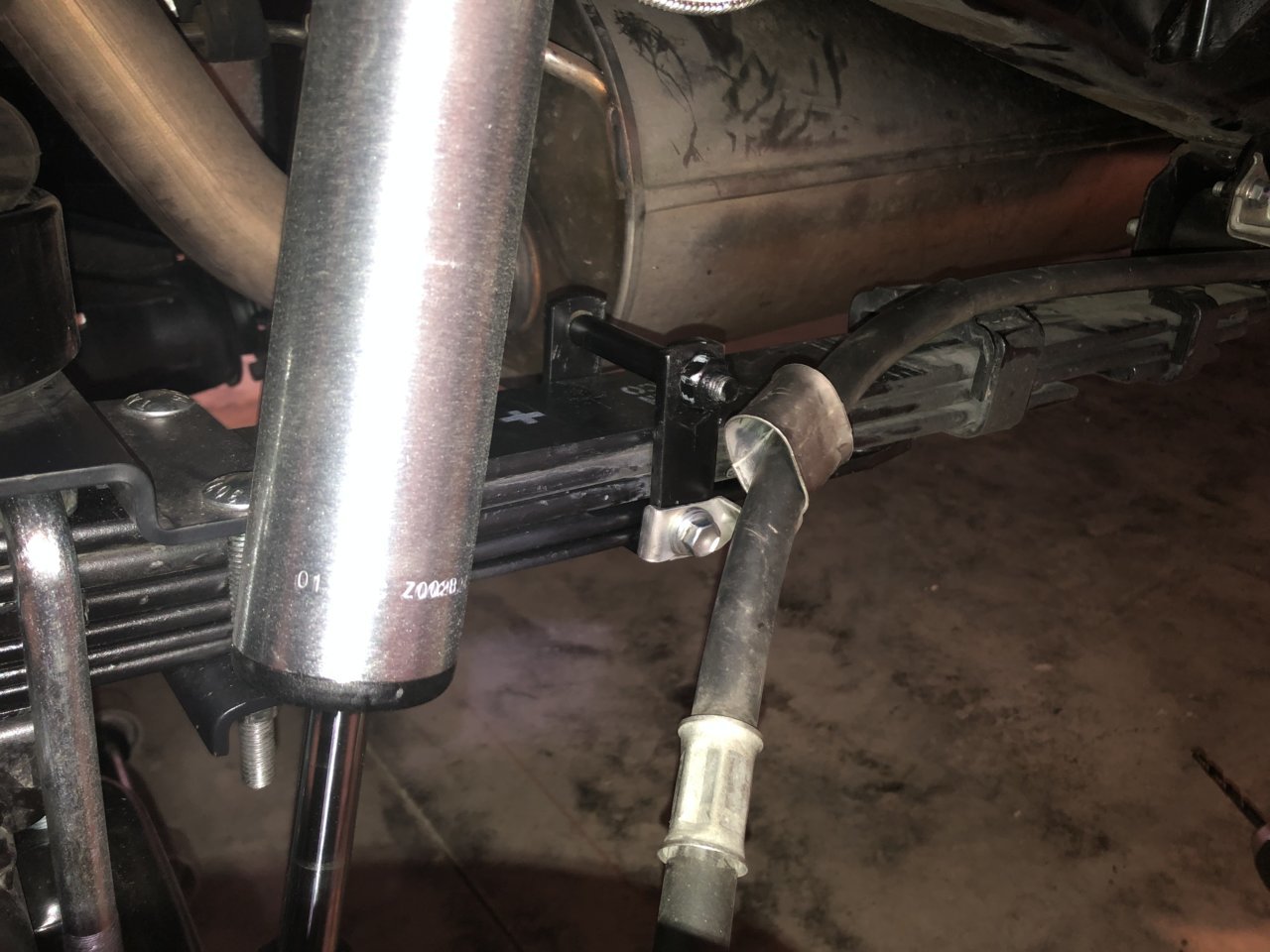

    BDS suspensions part # 02466 rear e-brake cable brackets. I had order them from a local authorized BDS dealer 20-30 bucks can’t really remember. Picture can be found on their website under kit instructions PDF right above the shock absorbers in the pic. http://bds-suspension.com/instructions/028601.pdf
    503MIKE likes this.
  13. Jul 13, 2019 at 7:33 PM
    Regcab05
    Regcab05 Well-Known Member
    Jul 12, 2013
    #108122
    119
    David
    Atlanta
    05 regular cab 4x4
    And installed picture on figure 36.

    If you want to put it on the icon aal in a lower position drill it out with a 17/64 and tap it M8x1.25.

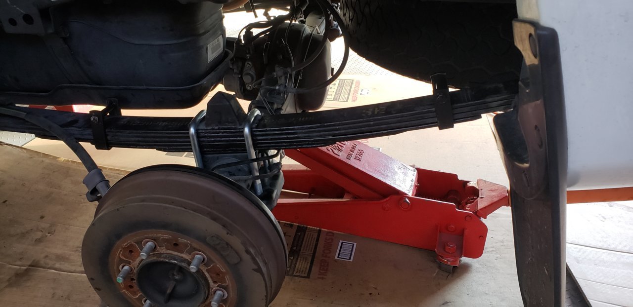

    I've had a zip tie on mine for almost a year now lol. When a few of us installed @kwolf9202 Icon Stage 4 we also zip tied it and I don't think he has changed it.
    Used some 100lbs zip ties I had laying around, it's not going anywhere

    Stealing part of @ssmith0480 's picture but literally the bracket on the brake line to the leaf bracket.
