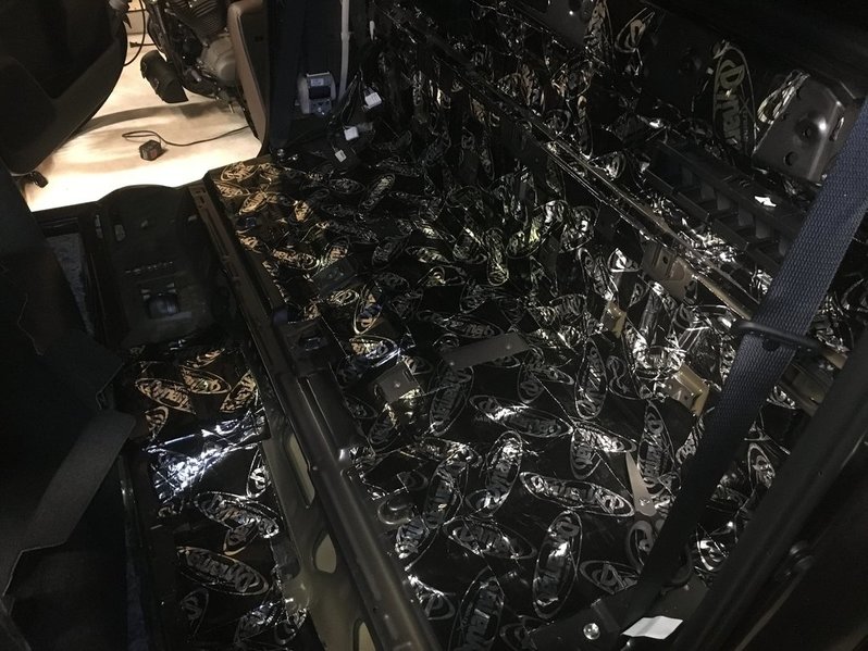

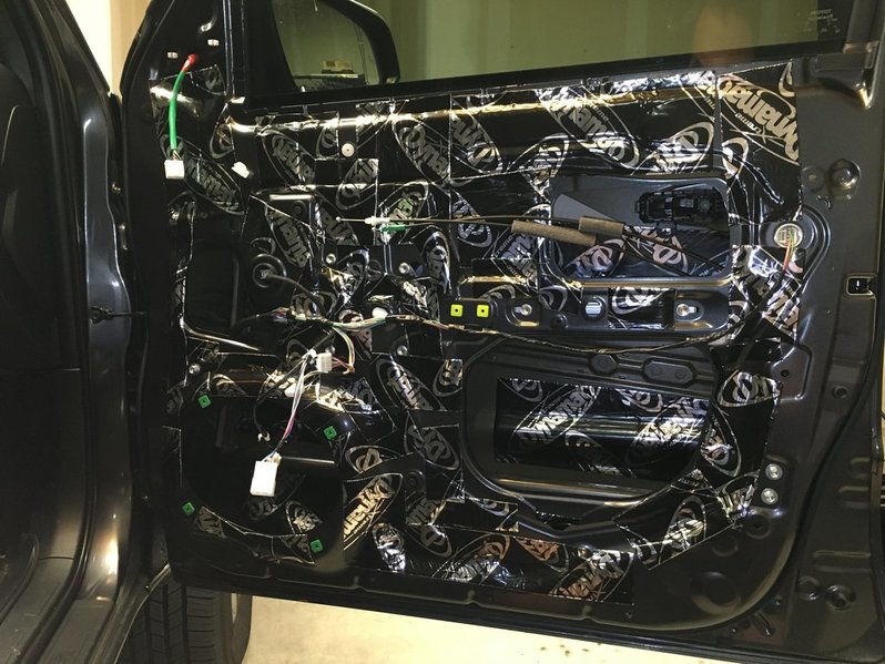

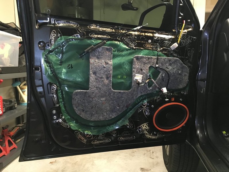

    I just installed dynamat in my truck. I did it mainly to improve the already great JBL system and to remove some buzzing panels in the door.
    It was definitely worth installing it in the doors. I also installed it in the back of the truck, not really needed the truck is already pretty quiet, but I did notice a reduction in noise coming from the back. Installing in the interior of the cab is not so much fun but doable in a day.
    If you choose to do so I recommend two door kits and one bulk pack for the interior.
    http://www.amazon.com/gp/product/B0...id=1453439431&ref_=sr_1_2&s=automotive&sr=1-2
    http://www.amazon.com/gp/product/B0...id=1453439431&ref_=sr_1_1&s=automotive&sr=1-1
    Here are some pics to give you an idea:

    Thank You so much for this great info and pictures: exactly what I needed. Greatly appreciated.
