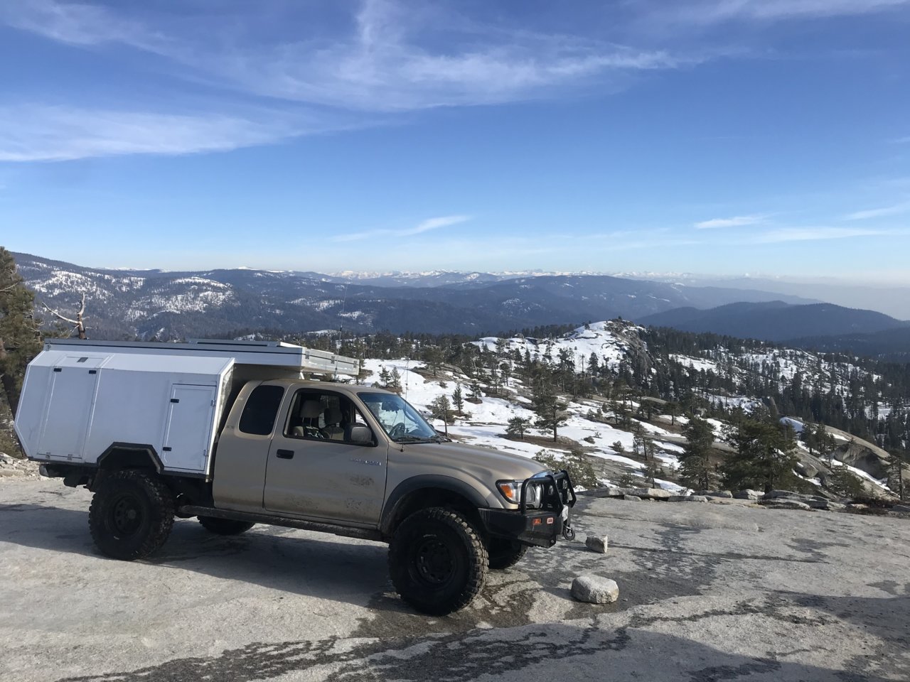

    I’ve since found a better way to dust proof.
    I replaced my camper shell and the bed of my truck with a camper I’ve been building for the last 13 months. It’s been down a few thousand miles of dusty dirt roads in California and Baja.
    Dust does not get in.
    At all.
    None.

    Showoff
    :muscleflexing:
