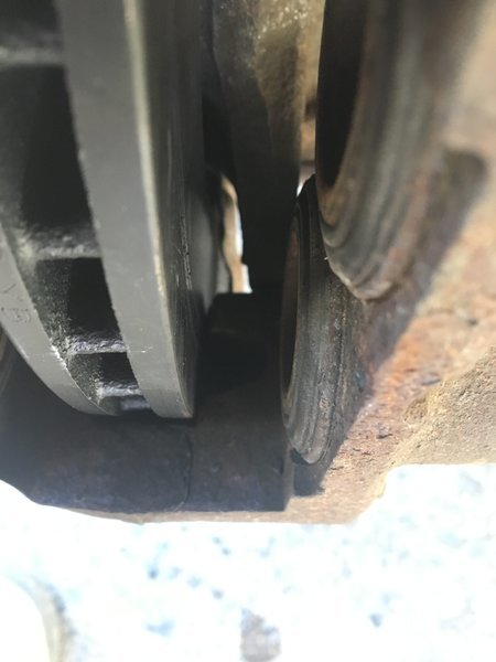

    Has anybody ever bought duralast gold rotors and had them not fit their 1st gen? I bought 2 the other day and neither one fits without rubbing hard on the calipers. I've never seen that before and I've changed a lot of brakes. Comparing the old and the new they look exactly the same but the old rotors turn just fine. IMG_1222.jpg

    Older tundra rotor were thicker but same size.

    According to their website all the tundra part #s are different than the Tacoma

    make sure to "chisel" away the built up rust and brake scale before putting in the new rotors. along the side where I see it's rubbing and where the outside diameter would be

    OP, you may have gotten the wrong part#, with a larger diameter.
    Even OEM sometimes has quality control. When I did my Tundra brake conversion,
    I bought 2 new OEM rotors. One was warped. No problem exchanging for a good one, though.

    Might be enough rust on your old calipers I most often install new rotors and rebuilt calipers .
    Might be a mix of Rust on the calipers and Rotors being a bit over size but not enough to be rejected
    put the pads on take it for a ride
    I would bet it cleans off and quits rubbing in less then 10 miles
    Wash the metal dust off and call it good
    This is about 99% Satire But I have had things go where i would have done just this .
