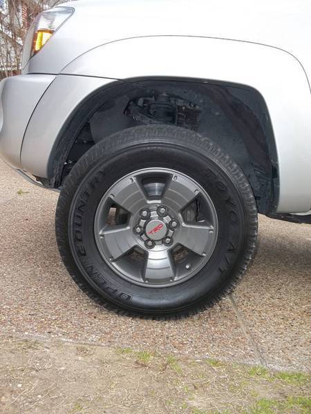

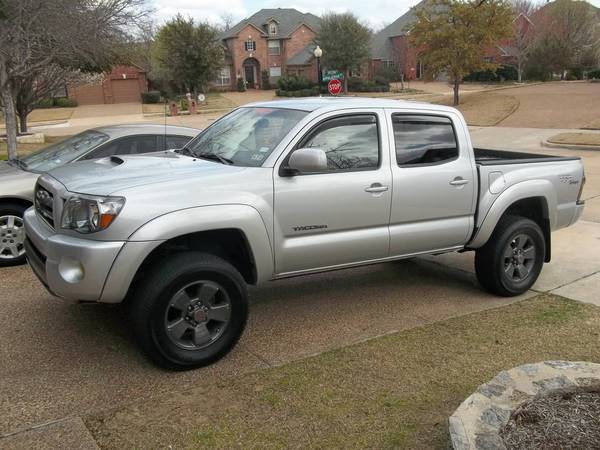

    Works great, painted my 09 sport wheels with the "graphite" color they offer. They looked amazing and no chips after 3 years. The key is prep and proper painting. I washed, sanded, washed, primed (used a heat gun to help cure too), sanded, painted, cured with heat gun and then let them sit in the house for 1 day to lettue paint harden properly. When I traded in my 09 the dealer asked where I got the special edition wheels. I told him they were not special edition, just painted. He then asked what shop did the great work...made me feel good about my work. I took my time and did it over a 4 day vacation.
    Here are some pics of my 09 painted wheels

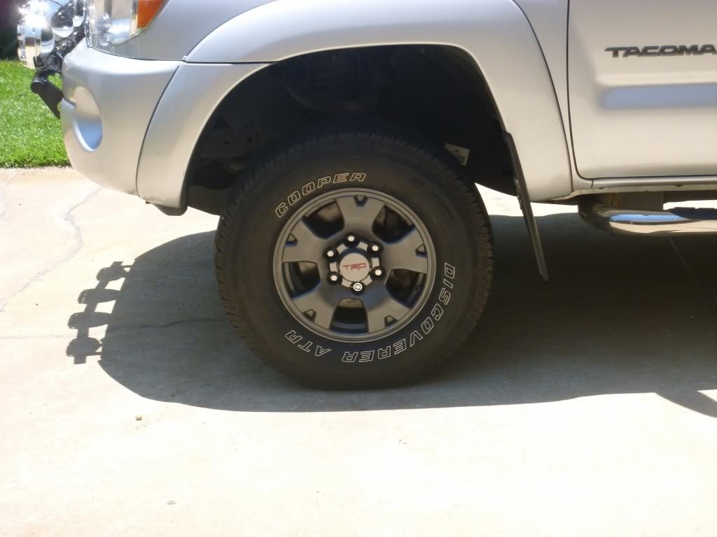

    Did my stealies a while back.. Need to sand them down and redo them.
    I sandblasted them, washed them, let them dry, drove for a few days bare, then put down only Dupli-Color Graphite (no primer)... Do not do this.. Rust is starting to come through the paint.. It's by no means bad, some light sanding and I'll prime and paint!
    After paint
    Later
    [pic coming soon]

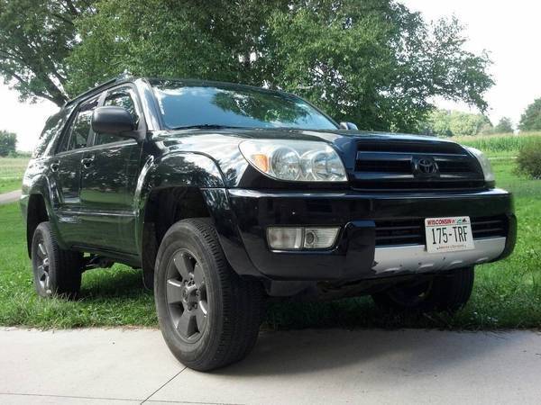

    We used it on the 4Runner's wheels. It worked very well. Didn't bother with clear coat. It has held up very well and is a nice color!
